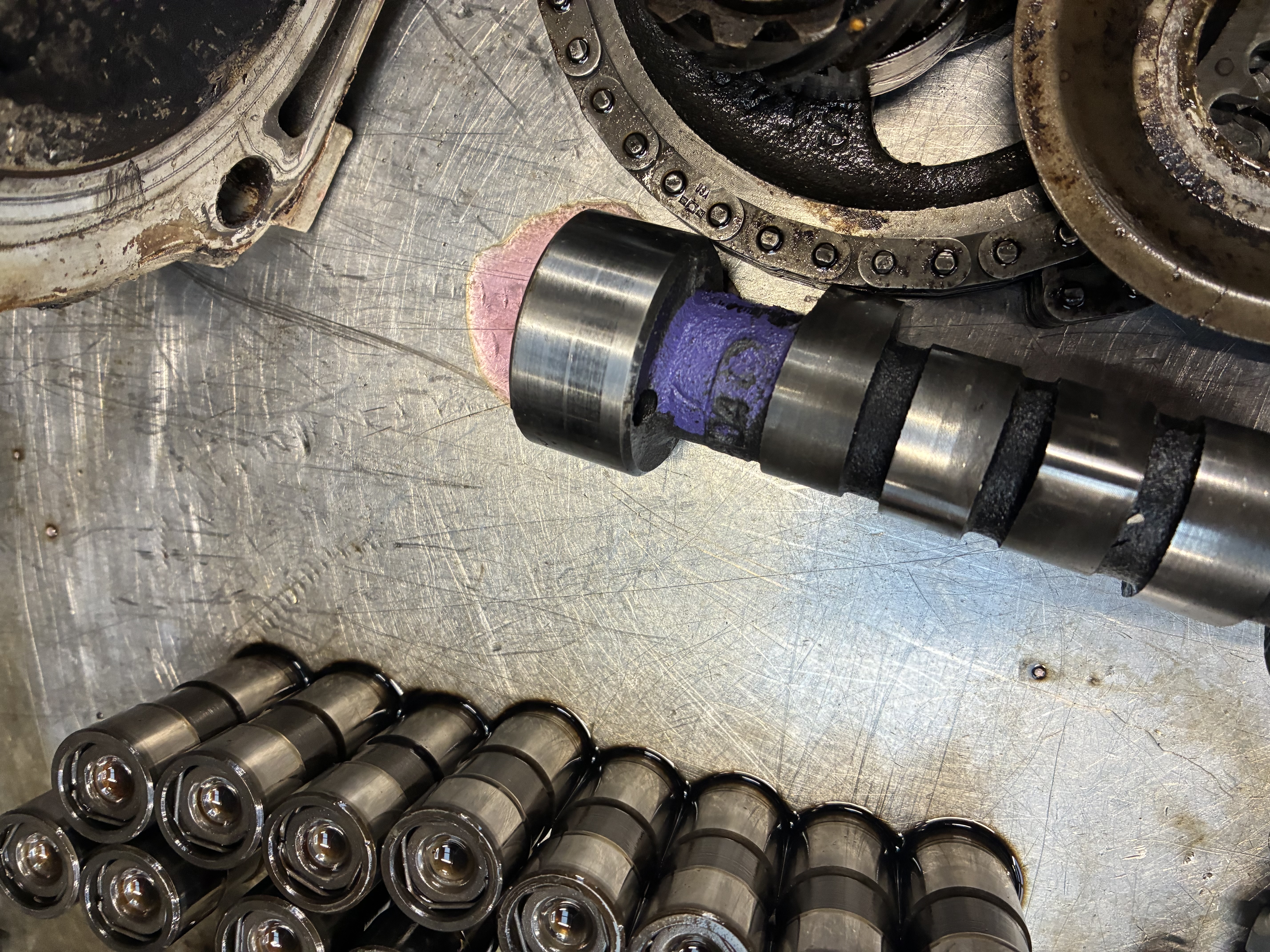

Hello,
I’m helping a friend strip and assess his engine.
It’s a 3.5 block with 10.5 pistons, tin gaskets and 29cc heads.
Not measured yet but guess a super high compression.
The cam shaft has CWC stamped on it and purple paint.
Has adjustable cam chain and machined to take a retaining plate so know it’s not standard.
Would anyone know?

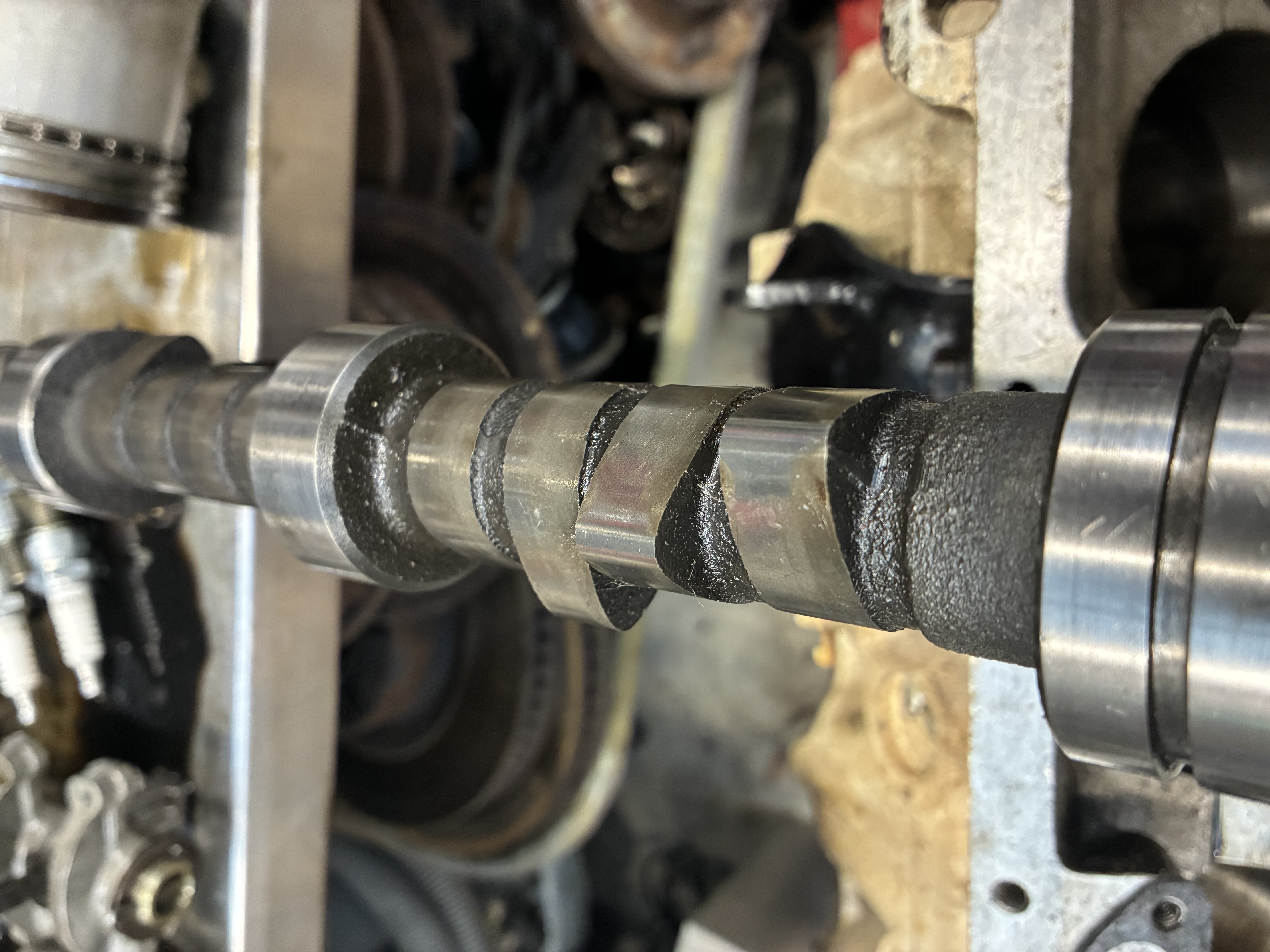

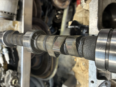

Sorry for delay.
There’s nothing stamped on the back of the cam.
I’ve attached a picture. If that helps.
CWC
K5
04
Is all I can see.

Visually, it could be a standard camshaft.
It also has the CWC marking and no stamping on the face.
You should measure the cam lift.
In my opinion, that doesn't match the compression ratio at all. Are those really 28cc cylinder heads?
