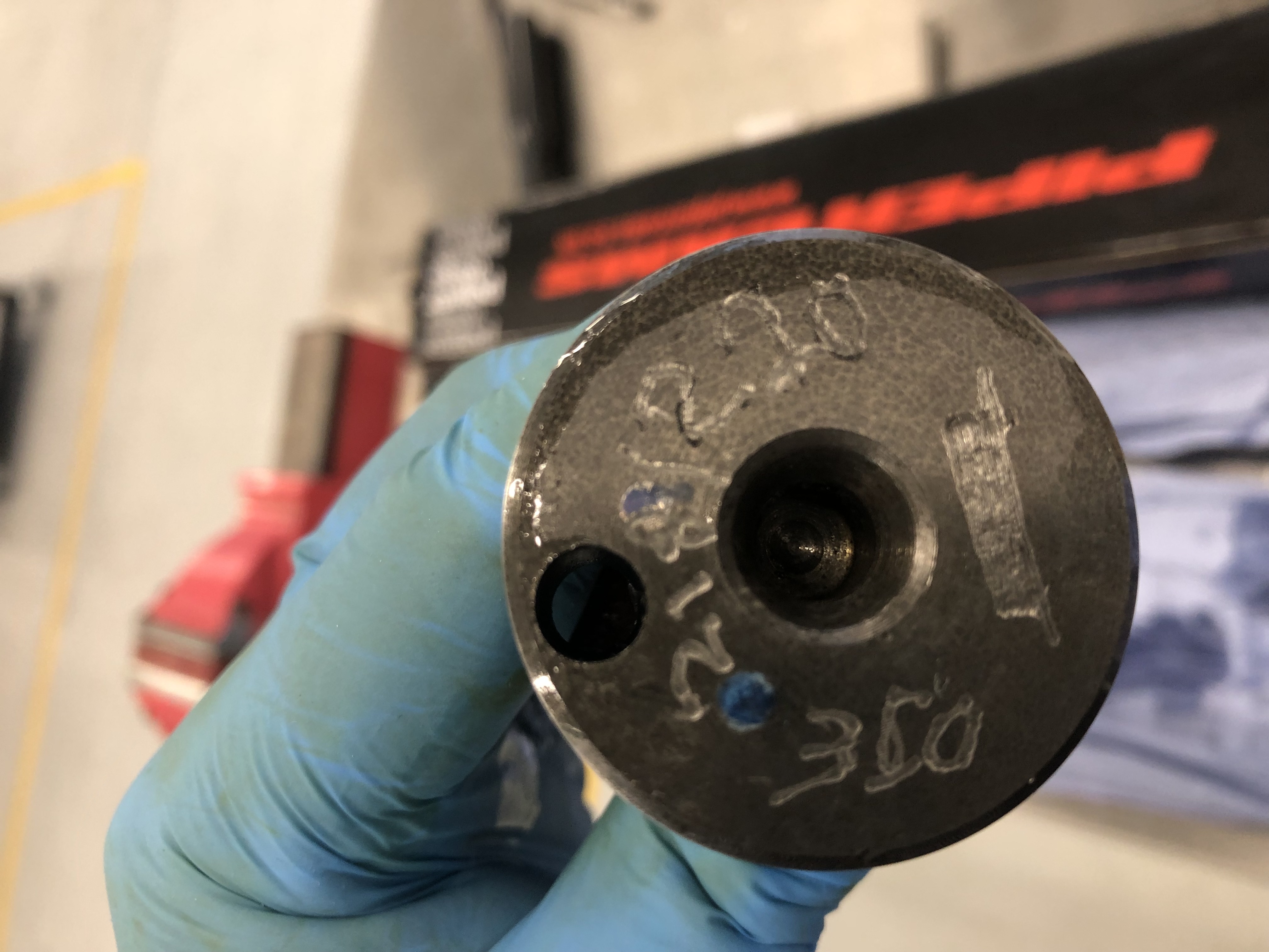

Well I have the 'old' cam out now and taken a couple of photo's:
Seems to be marked on end DJE 218/220 (the DJE may not be quite correct) with a small section wiped out and a couple of small blue marks.
On the side of the cam just before the second (from front) journal there is a white(ish) dot.
Does this prove absolutely that this is a Viper Typhoon or something else?
