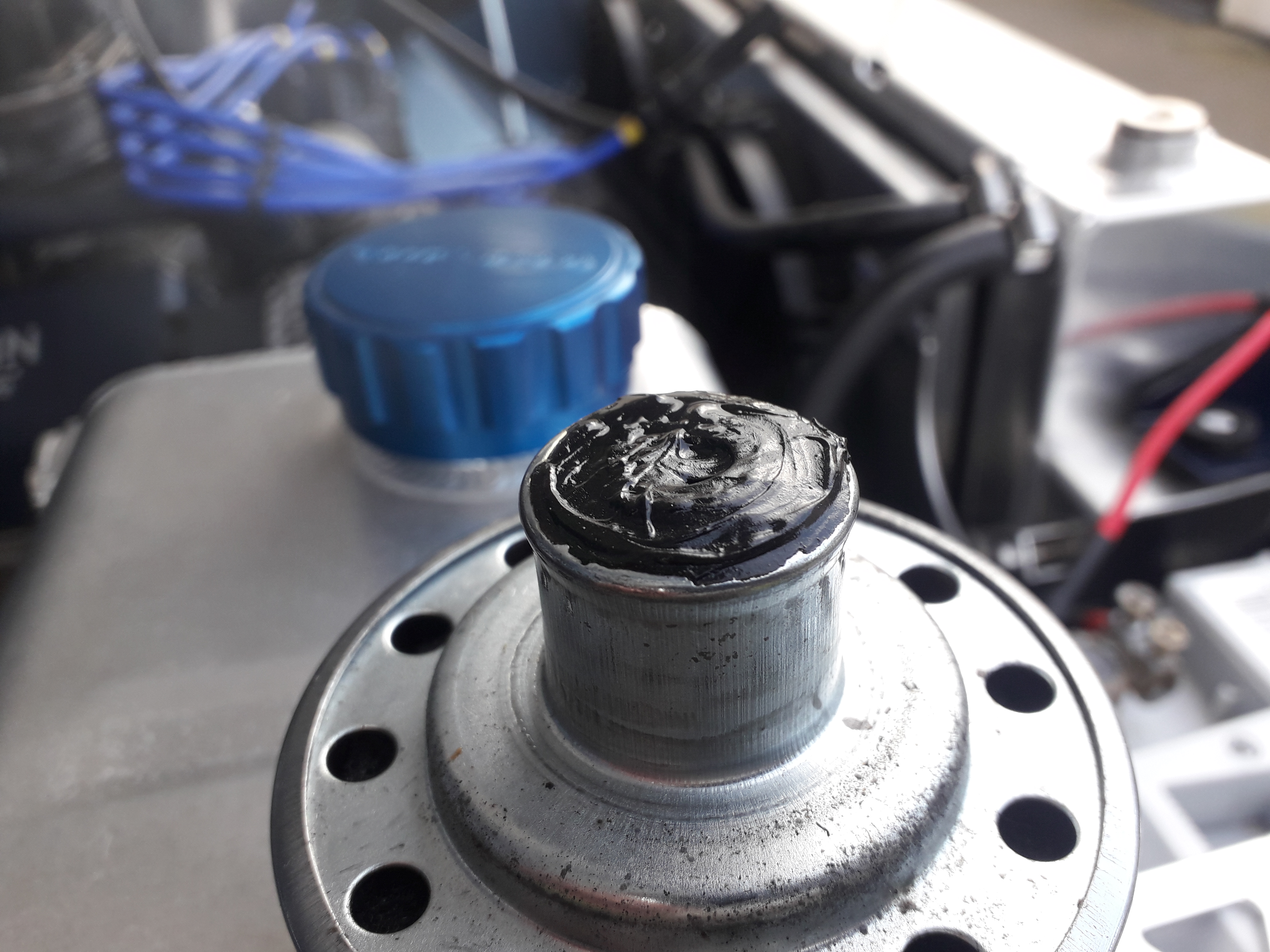

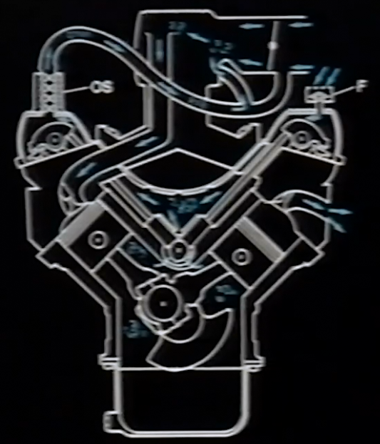

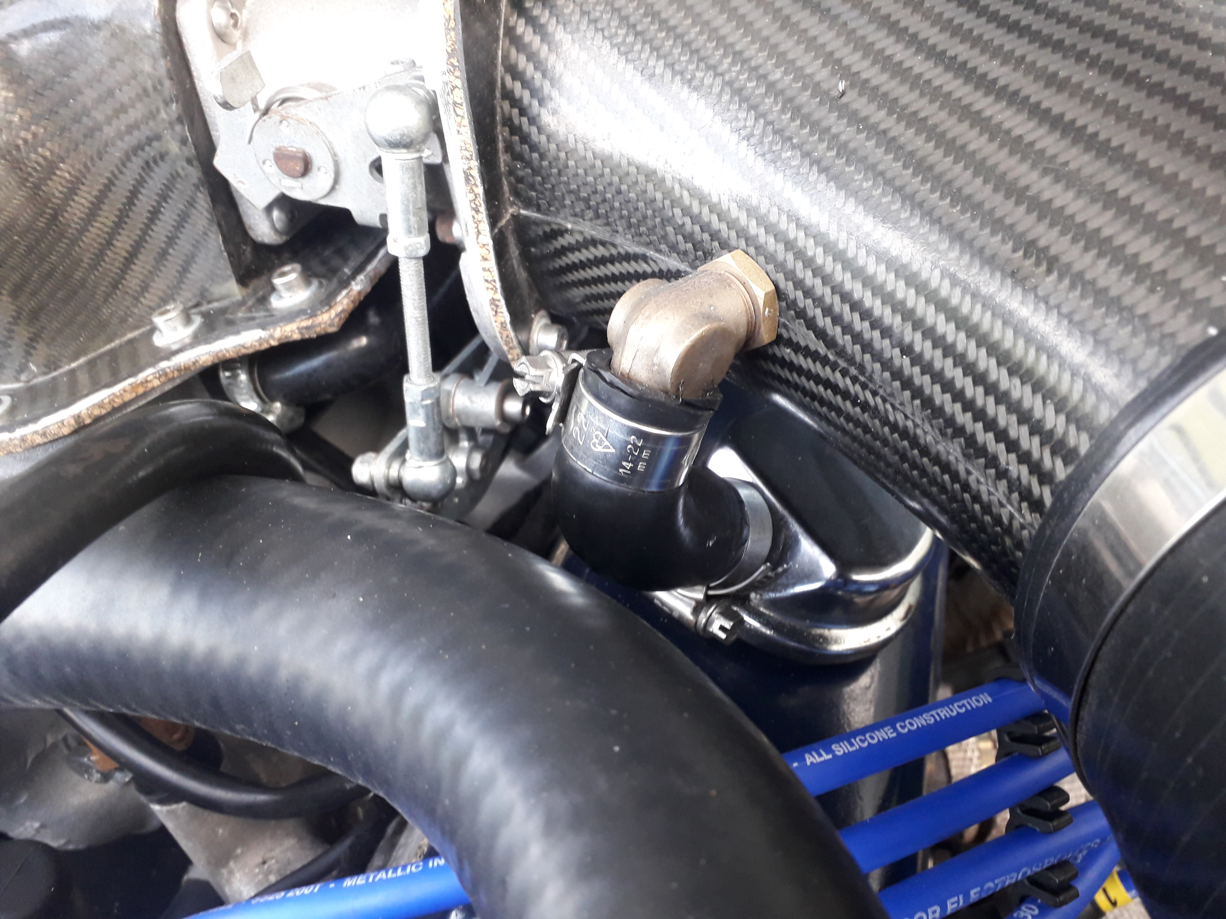

Question about Crankcase breathing.
I have always been puzzled as to why RPI blocked off the rocker cover air intake filter with a blob of silicon -
On the passenger side there is an outlet that feeds directly into the atmospheric side of the throttle butterfly from the rocker cover flame trap -
Comparing this to the original Hotwire system there is an intake filter on the passenger side rocker cover, a flame trap on the drivers side that has a similar pipe leading to the outer side of the throttle butterfly and in addition a pipe leading to the plenum. In my case RPI put a blanking sleeve over the plenum intake. This is taken from the Hotwire training video -
The Thor system from what I have read uses the pipe on the atmosphere side of the throttle butterfly as its intake, this goes to the passenger side rocker cover. The air goes through the crankcase and exits through the drivers side rocker and into the plenum.
So in both cases old and new they have an air intake and exit, I only seem to have the one connection.
No longer trust what RPI have done any opinions on what should be there?

heli_madken wrote: Thu Oct 09, 2025 4:06 pm Question about Crankcase breathing.
I must admit I've always been a bit confused by this system. Mine is setup as I believe you are describing with the small filter on the rear of the LH rocker cover (possibly including a metered orifice) which will be an inlet with gas extracted from the flame trap on the RH rocker cover. The pipe from the flame trap Tee's off to the plenum with a small bore tube (possibly with a controlled orifice inside) while a large bore tube goes to the throttle body area on the MAF side of the butterfly. This seems to give the possibility of unmetered air entering the engine.
Presumably this would only be an issue at low throttle openings when plenum pressure is low as is metered airflow. Obviously it must have worked as it was used without issue on many vehicles.
RPI really seem to have been up to some cowboy antics here throwing some very expensive parts together with some very questionable 'glue'.
Rather than considering reverting to carburettors as you mentioned in previous post how much work would it be to return to a standard 14CUX system, at least temporarily?

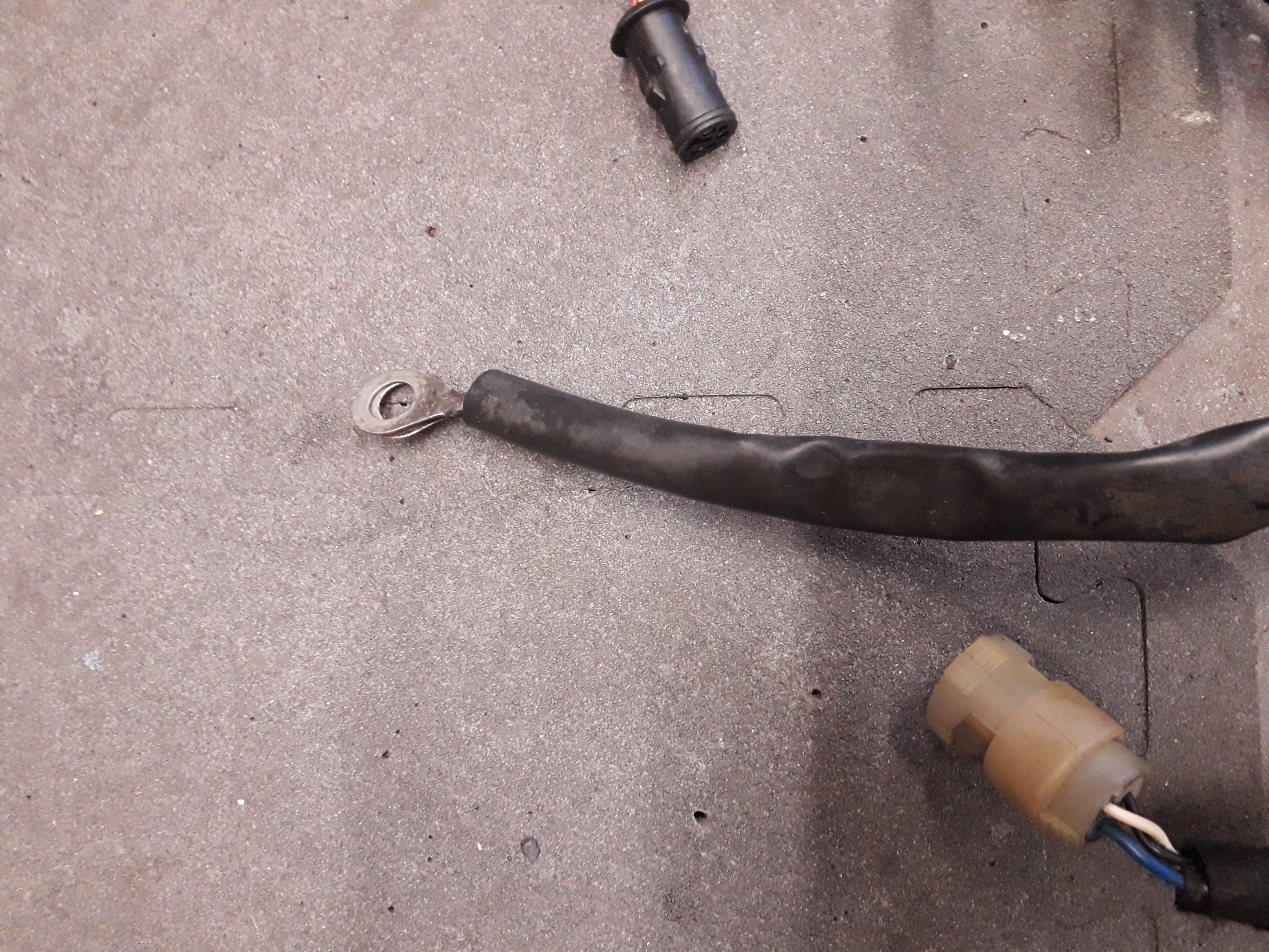

Ian Anderson wrote: Fri Sep 26, 2025 6:32 pm Is it perhaps something simple as a bad earth/ground connection
You could be right!
I decided to strip out the engine loom as I have never been happy with what RPI supplied. During removal I found a group of earths tucked down out of sight at the back of the block which I have never noticed before. The bolt holding them on was hanging on just by a few threads I was able to remove it by hand -
Not traced them through yet but I remember reading somewhere that they are important for engine running.
Have I found something significant do you think?
The latest misfire issue started after I had worked on the injectors I must have disturbed the earths in some way during disconnection/reconnection.
Posts: 2458
Re: Problems with new Rover 4.6 Engine
I would think so hence my check the earths comment a while back.
Could the plugs be too hot a grade ….I cannot see where you mentioned what you had fitted. I seem to remember BPR6ES plugs.

Unwrapping the loom both Lambda sensors earth through the point I have found so that isnt going to help.

I havent tried the engine since finding the earth issue, I am doing what I should have done in the first place stripping all the loom tape off the engine loom and have a good look for any issues.

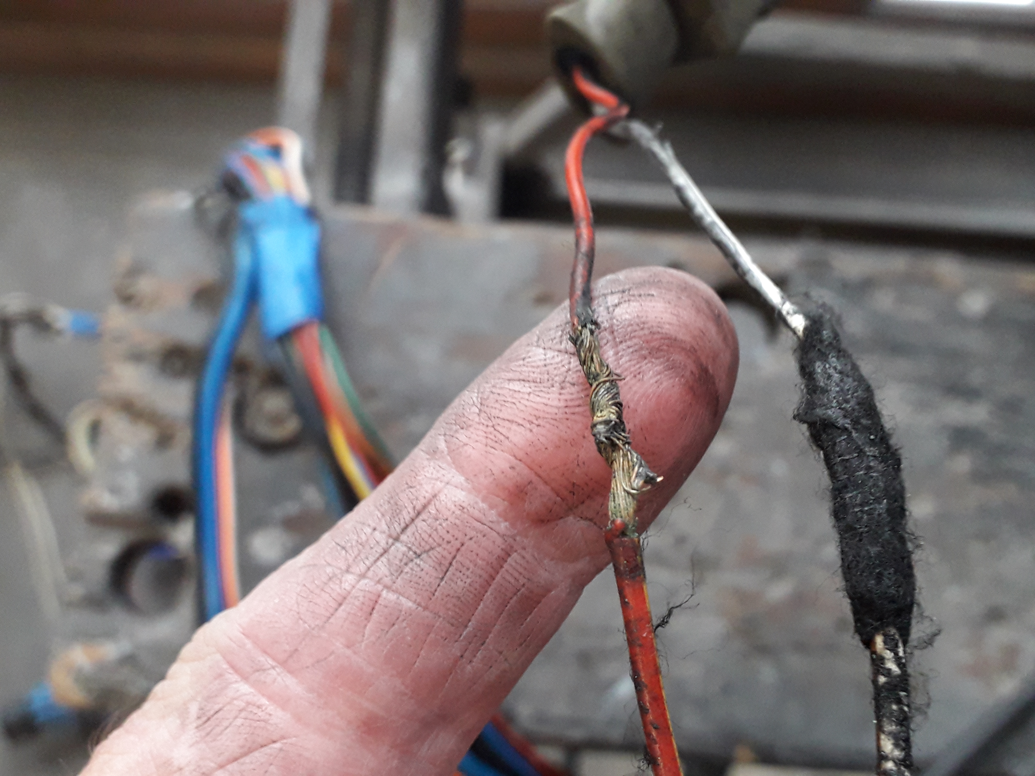

This is the sort of thing I am finding, all done by the same person as they didnt have any insulating tape handy or a soldering iron so either left connections bare or wrapped with loom tape and wires just wrapped together -
This is the ECU water temperature sensor cant imagine it was working with the correct values at all. Not sure why you would replace a faulty plug then make a pigs ear of connecting it.
Going to check every last wire for continuity and re-wrap.

heli_madken wrote: Mon Oct 13, 2025 12:19 pm This is the sort of thing I am finding, all done by the same person as they didnt have any insulating tape handy or a soldering iron so either left connections bare or wrapped with loom tape and wires just wrapped together -
That is absolutely horrific, complete disgrace! I always try and look for the positive so what I'd take away from this is that even if that is not what is causing your problem now it would be doing in the future so good to find and sort early on.
The fact that this is your temperature sensor could contribute to your issues as an incorrect reading would lead to incorrect fuelling. Only thing I would say is that if the temp' reading was low the result would be adding fuel, running rich rather than lean.
Completely checking that loom is the only way to go.
Keep at it, I'm sure there will be more horrors to find.

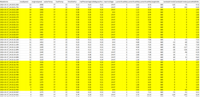

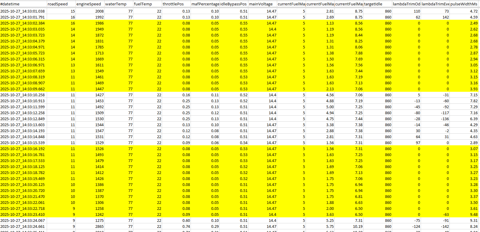

So with everything back together I was able to go for a run today. I did about 25 miles without any sign of a missfire so hopefully it was that loose earth.
The engine idles better, dont think there is any difference in power but didnt push it today. Also seems to be running cooler.
With a new laptop I was able to get some logs. To be honest I dont know what I am looking at yet but the lambda's seem to be trimming wildly in both directions but mostly adding fuel (I think?), here is an excerpt -
Plugs are still quite white.
Is it normal for the lambda's to be trimming in that way?
Posts: 567

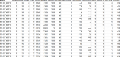

I am trying to see if there are any patterns in the logs the only thing I have spotted up to now is with the throttle closed all trimming immediately stops, is the triple throttle body overwhelming the capacity of the 14CUX to handle the volume of air entering the plenum?
I am also not sure as to why the idle control valve is opening whilst on the move, accelerating etc, is this normal -
Math is definitely not my strong point and I am not sure how to format the data but if I format the the column as a percentage its showing as being above 50% for most of the time
