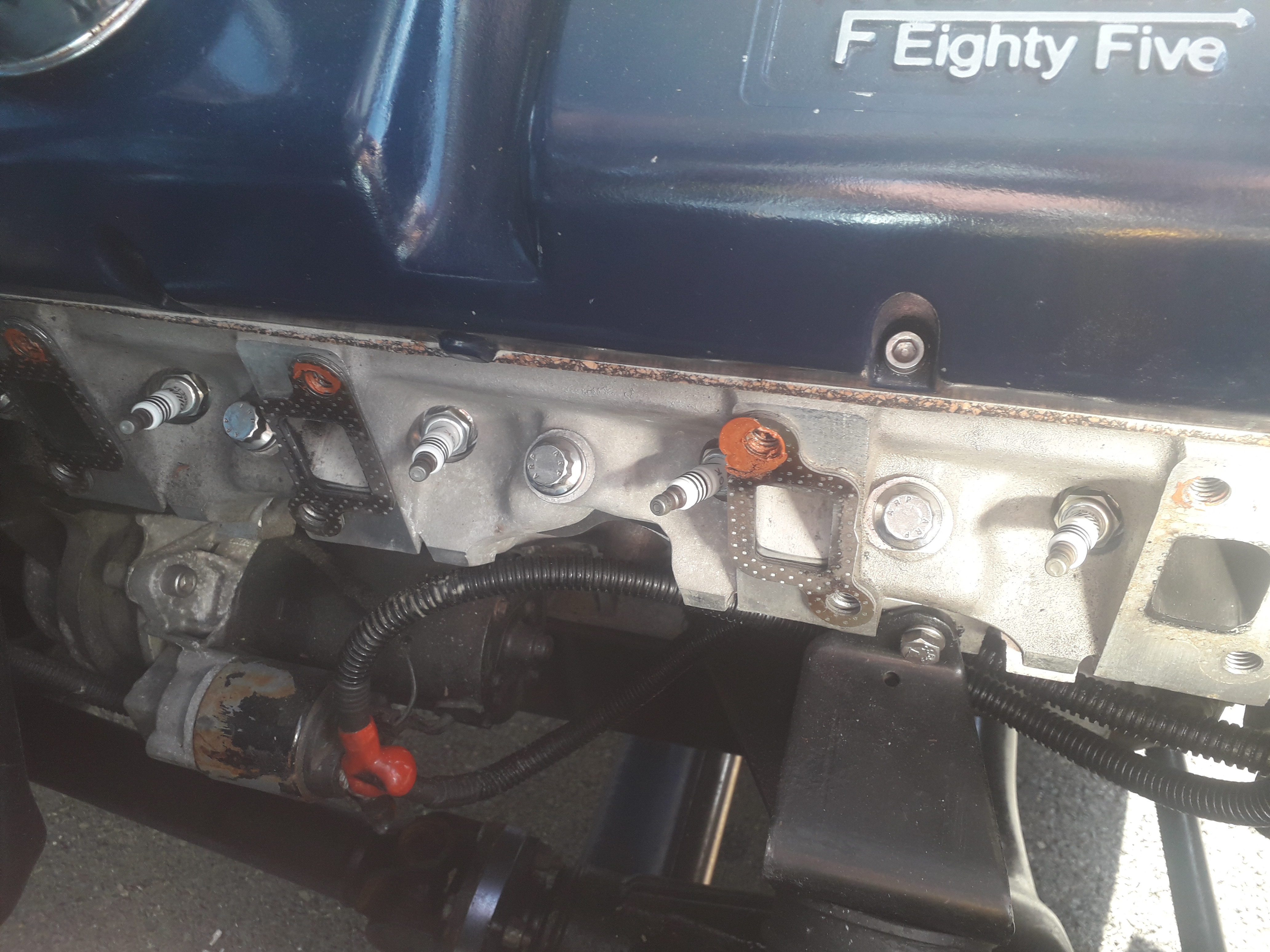

I noticed the other day that one of my welds was a little porous (crap welder) on the manifold so decided to take it off and this is what I found - Not very clear but look at the exhaust ports, 2 and 8 are how I would expect to see them, 4 and 6 are completely clean like they have never run.
I did think I had a head gasket problem perhaps but their is no evidence of one - not using any water, no steam from exhaust, nothing in the coolant, no scum on oil cap, no clean plugs. I did a sniff test a week or so ago just to make sure which was ok. Not done a leak down test yet.
For the ports to be this clean it would take a hell of a leak on those two cylinders but I cant believe I have been driving on 6 cylinders all this time is there anything else that could cause this?
All plugs are identical, a little on the white side which shows some overheating but all the same.
Assuming there isnt another reason for this the obvious culprit would be the injectors, all are new 4 hole Bosch units. What should I be seeing with a test meter from an electrical point of view?
Anyone come across anything like this before, any thoughts and help would be appreciated.

If you suspect the injectors, swap 2&8 with 4&6 and see what happens.

So if you are sure they are getting a valid signal, then swap those injectors with another cylinder. Or if wiring reaches, swap wiring from a good cylinder, to the bad cylinders and see if it moves.heli_madken wrote: Fri Sep 05, 2025 11:10 am Noid light shows that electrically 4 and 6 injectors are getting a firing pulse
Also confirm you have spark on those cylinders.
And that the valves/rockers do open/close as expected.
Get a heat gun when running to determine if those two pipes are colder than the rest.
