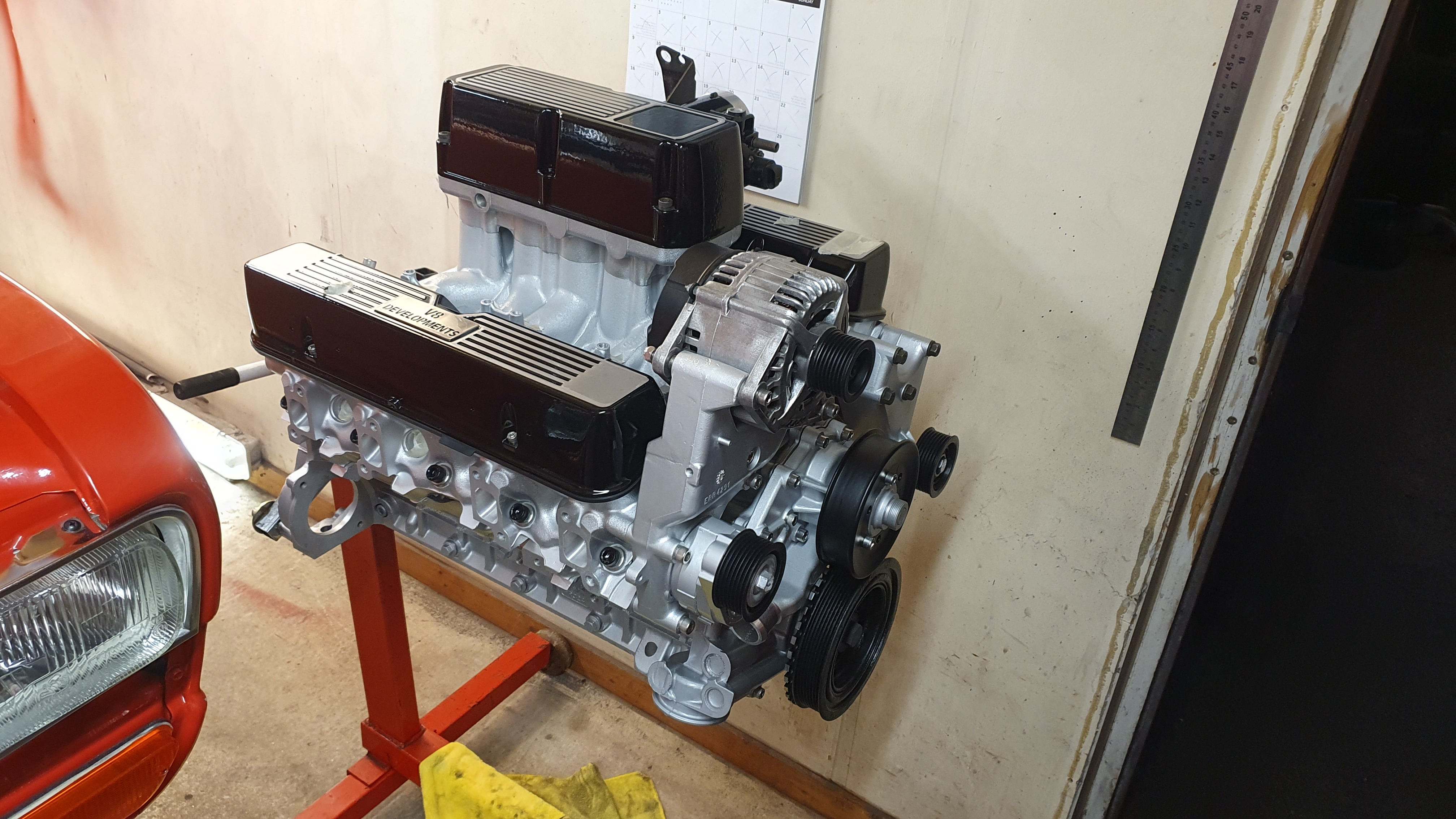

Hi everyone! Thank you for accepting my request to join the forum! I am currently in tha latter stages of the build on my '74 Vauxhall Viva HC whic my wife named "Valerie". Cheers. Leigh.

Welcome to the mad house…that car sure looks like a bundle of fun

Hi Ian! Madhouse you say? Just how I like it!! It should be a riot! Narrowed Mk5 Cortina Atlas, 3:44 cwp, rebuilt Capri 280 ZF lsd, Escort gp2 bearing housings, Quaife en30b 2 piece halfshafts with blank drive flanges drilled to 4" pcd Mk3 escort discs, Cossie calipers & custom Gaz coilovers on the rear, Cossie T5 gearbox with a TVR bellhousing, Land Rover Clutch & more TVR bits! Should be 300 ponies at the crank... plenty of fun!! Cheers. Leigh. PS: Glad to be here!!

Hi Ian! Forgot to mention the axle is 6 linked. Cheers. Leigh.

Looks like TVR-esque exhaust routing.

scudderfish wrote: Tue Jul 01, 2025 2:02 pm Looks like TVR-esque exhaust routing.
Hi! Yep, it was the only way to get downpipes that wouldn't be a pain!!
