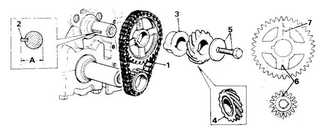

Re: 1990s Range Rover 4.6ltr V8 Timing failure
Looking at your cam dizy drive gear again - the corner looks quite rounder off - vs the genuine gear which has quite sharp corners - though it is hard to tell from your images.

Thanks to all, this is very useful information as I thought the helical gear was part of the CAM shaft. Now I know it can be replaced separately it should be a much simpler and cheaper job!
