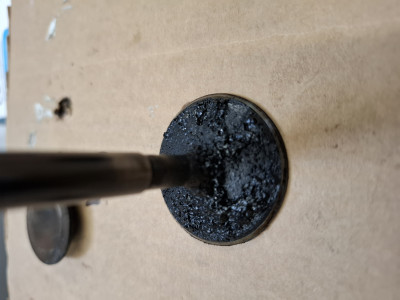

Thank you for your very comprehensive response. I have just started investigating the sensor issue starting from scratch with a cylinder leak down test and compression test.
All appears good except I have found a badly leaking No3 cylinder exhaust valve so I am now in the process of removing the head. Unfortunately this is not in the same bank as the sensor exhaust.
I will update if I find the cause of the sensor failure but might not be until the summer of 2025 when the car is back on the road.
Many Thanks for your help with this

Thanks for your replay Sevieturbo.
As you have stated there are many things that could cause an O2 sensor to fail although i didn't know exactly what. I am now looking at any potential contamination. Compression tests and leak down tests were good except I found a leaking exhaust valve but this was not in the same bank as the sensor.
What I have found is that all head chambers have an oily deposit and the inlet valved have a tar like coating on the flow side. It is my opinion that this oily tar like contamination must have come via the PCV system as valve stem seals are good and this engine has only done 10K miles. Cylinders still have the cross hatch marks so together with the compression and leak down test are looking good.
To that end I am firstly trying to find out what the oil level should be in relation to the crank or bottom of the block and have asked on this forum but no response as yet. If I don't find anything conclusive I will just vent the PCV to atmosphere via the oil catch tank and monitor the condition of the chambers.
I don't think it is water contamination as the coolant system looks sound and the sensor is installed at circa 15 degree angle.
So at the moment I am cleaning up the heads and lapping the valves before reassembly.
I'm happy to consider any other suggestions
Many Thanks
Allan
[attachment=0]20241030_101912.jpg[/attachment]
Many Thanks
Allan
- Posts: 4112
Re: Holley Sniper issues
Water contamination tends to be from condensation from cold starts
Some places even suggest to delay sensor heating for a short period to try and reduce water droplets getting onto a hot sensor, instead having the engine warm up a little first ( although obviously the sensor will not be reading during this time if that matters )
Other common guidelines are sensor mounted high in the pipe, not at the bottom, and close enough to the valves it will get heated quickly naturally, but not so close as to cause overheating ( not likely on a n/a engine anyway )
But as said before, if you're using Innovate as a controller, they do their own thing and IME it kills sensors far faster than using normal control methods pretty much every other wideband controller uses.
But generally in normal use you should get a long time out of them
Is that photo of a valve from your engine? If so that looks in a bad way for 10k miles. I'd say that's indicating a problem with the engine or possibly an incorrect oil level as you have suggested.
This can be a bit difficult on the RV8 as it came with different combinations of dipstick and dipstick tubes, some coming higher out of the block than others, If you have a long tube and a short stick you will have a high oil level, the other possible combination is worse!
I took a measurement on mine a few years back when had the engine out, this was from the sump mount face to the level on the stick unfortunately I don't have that value to hand right now although I do seem to recall putting something on a thread on this site about it as someone else had issues at the time. IIRC it turned out their sump was non-standard with very much reduced capacity so for the correct quantity of oil the level in the sump was rising too high. Is your sump standard.
The other problem with the stick is it doesn't go straight down into the sump, it goes at an angle so the distance between min-max is not that same as the difference in levels measured vertically.
I think you are on the right track breathing the engine into a catch tank, at least for a while so you can check what is coming out and how much of it.
