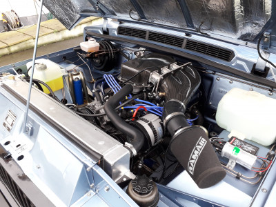

The engine is fitted with the earlier front housing so it is not a serpentine belt type front end. Everything is basically new and I have no reason to suspect any individual component isnt working as it should.
This is how it looks fitted -

Doesn't look like a very friendly engine bay to work around, so checking cam timing whilst yes a sensible idea...doesn't look so easy. But would be worth doing.
But equally, so would checking ignition timing is actually where you think, and also checking fuelling whilst driving, to ensure it isn't miles out.
And other obvious things like the throttle is actually opening correctly, no blocked exhaust etc.

8° of advance seems a bit conservative and you say you don't have any information regarding what the distributor is.
Do you know what the advance characteristics are?
Also worth checking that the timing pointer is in the correct place relative to the pulley markings many different pulleys and pointers available, get the wrong combination and it won't read right.
I'd resist jumping to a new ECU, that's going to be a lot of work, cost and a whole new set of problems to solve and the 14CUX is not as evil as many people like to make out, it is also mappable and tweakable these days so no need to replace just to get that capability. having said that one benfit would be mappable ignition

No Cats but RPI fitted the white tune resistor in order for some fuel trimming to take place. RoverGauge reports R3116 which when looked up was for a 4.2 engine. Speaking to Tornado though they implied the actual tune on the chip can be quite different to whats reported.
Should have said 10' advance sorry not sure why I said 8'. I have improved things today taking it to 12' definitily more responsive and power is building from 2500 RPM. Strange I thought I had tried this before without any result. No sign of any pre-ignition do you think its worth advancing a little further?
No idea of the advance characteristics of the distributor, looking at the pulley and reving the engine I would say its advancing around 12' at 3000 RPM which probably isnt enough? The distributor is something I am not entirely happy with, looks cheap but probably the same as all the others available now.
The engine is a bit of a mish mash isnt it various parts thrown together with a different front cover to the original 4.6 one so it can run a distibutor. So who knows what sort of curve it actually needs to perform. This is the reason I am thinking about megasquirt, at least then on a rolling road with someone who understands megasquirt this can be mapped to give the best results.
Let me know what you think about advancing further.

Thanks yes I think the distributor is the source of the problem.
Had a drive out today and with the 12' timing it is much better to drive, still feels a little flat low down but improved.
Everything appears fine with the distributor but it clearly isnt advancing as it should. The problem is all the original good distributors have gone now replaced by chinese stuff so its where to get a decent distributor.
The 123 programmable one fits the bill but it is expensive. My intention now is, as suggested, to get the car on a rolling road as is so I know I have a good state of tune with the 14CUX then maybe look at the Megasquirt system so not sure I want to pay out £800 on a distributor at the moment.
Anyone know of a decent distributor?

heli_madken wrote: Fri Feb 07, 2025 4:10 pm Thanks yes I think the distributor is the source of the problem.
Yes lambda's are fitted
Mechanical advance setups in a dizzy are pretty simple, Take it apart and see if it works, or can work. Likewise a vac advance can if fitted.
A slightly poor video, overly long, but it does show the workings.
And narrowband lambdas are all but useless for tuning, as they only give a reference to stioch, , or rich/lean either side of it.
For tuning you need a wideband setup.

I would double check your pointer & TDC crank pulley mark is actually at real TDC.
Mine was out quite a bit!
Use a piston stop tool in no1 cylinder (I made one out an old spark plug) and mark BTDC and ATDC on the pully - and the centre of these two marks is your real TDC. does this line up with your pointer?
