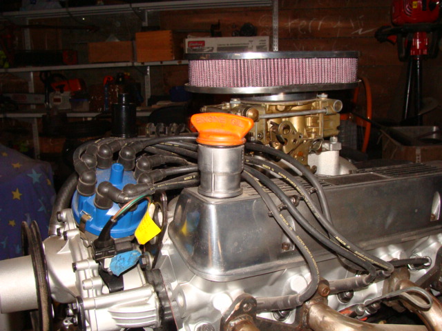

Just a thought , I have a performer manifold and a 390 Holley , which may not fit in an MGB but have a look at the bonnet ( hood ) line / profile of the MGC ( to clear the straight 6 under it ) ....... I mean its no BJ8 but still a nice aggressive hinting bulge .

Or just fit the likes of a Holley which can be serviced locally.
