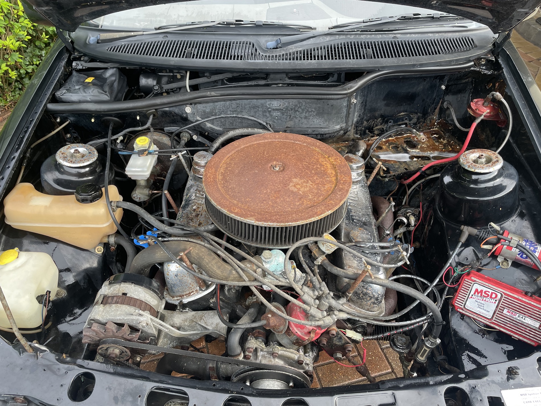

My son is looking at selling a Rover V8 engine that will need a strip and check over as it has been sat for a very long time.
It has covered 38000 miles since being built in the early 1990's
Made 333 bhp at the flywheel and 288 at the wheels on Oselli dyno.
It's a really good spec engine that will need some time putting into it and he will sell it for £600 untested.
It cost me a fortune back in the day!
Spec below:
4441cc SD1 engine that turns over fine.
450 mechanical secondary Holley (partially seized throttle spindles)
Harcourt single plane intake manifold.
Vulcan maxiflow 2 big valve cylinder heads.
Yella Terra roller rockers
Chrome molly tubular pushrods
Kent M238 mechanical cam
Steel timing gears with duplex chain.
Top had linered block with polished lifter gallery and 1/2" dural block brace that ties all the mains caps together.
Long stroke cross drilled TVR crank
Group A steel con rods
Mallory unilite distributor and MSD 6AL ignition box.
P6 front end.
Lightened SD1 flywheel.
Starter motor.
Alternator.
Small block Chevy rocker cover adaptors and rusty rocker covers.
Cosworth clutch and a converted bellhousing to fit a Cosworth T5 gearbox.
It has not been advertised anywhere but could make for a good starting point if you don't mind getting your hands dirty!

I removed the inlet manifold and one rocker cover to quickly check the engine.
It looks OK but would need a complete strip and clean.
I had forgot that it also has steel rocker posts
