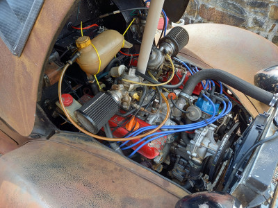

Having cooling issues with the 3.5 in my hotrod. New waterpump, thermostat and capillary guage, electric fan behind the rad. There's no heater jyst a bypass loop. Car gets too hot too quick even with the fan on it won't last more than a few miles.
Header tank feeds in on a T just below the waterpump and the tank starts off near empty. When the car gets hot there's a steady flow from between the carbs into the tank and a fair few air bubbles.
Firstly is my set up correct ? Someone suggested that the manifold tower to expansion bottle pipe should go in below starting water level as it could draw air back in. Certainly when it cools down it looks like it's maybe drawing air back.
I know the radiator is too small and thin but space is extremely limited and the front grill/bonnet has already been butchered to get that in. My thoughts are a similar size but much deeper core rad with the fan moved in front to make way.
