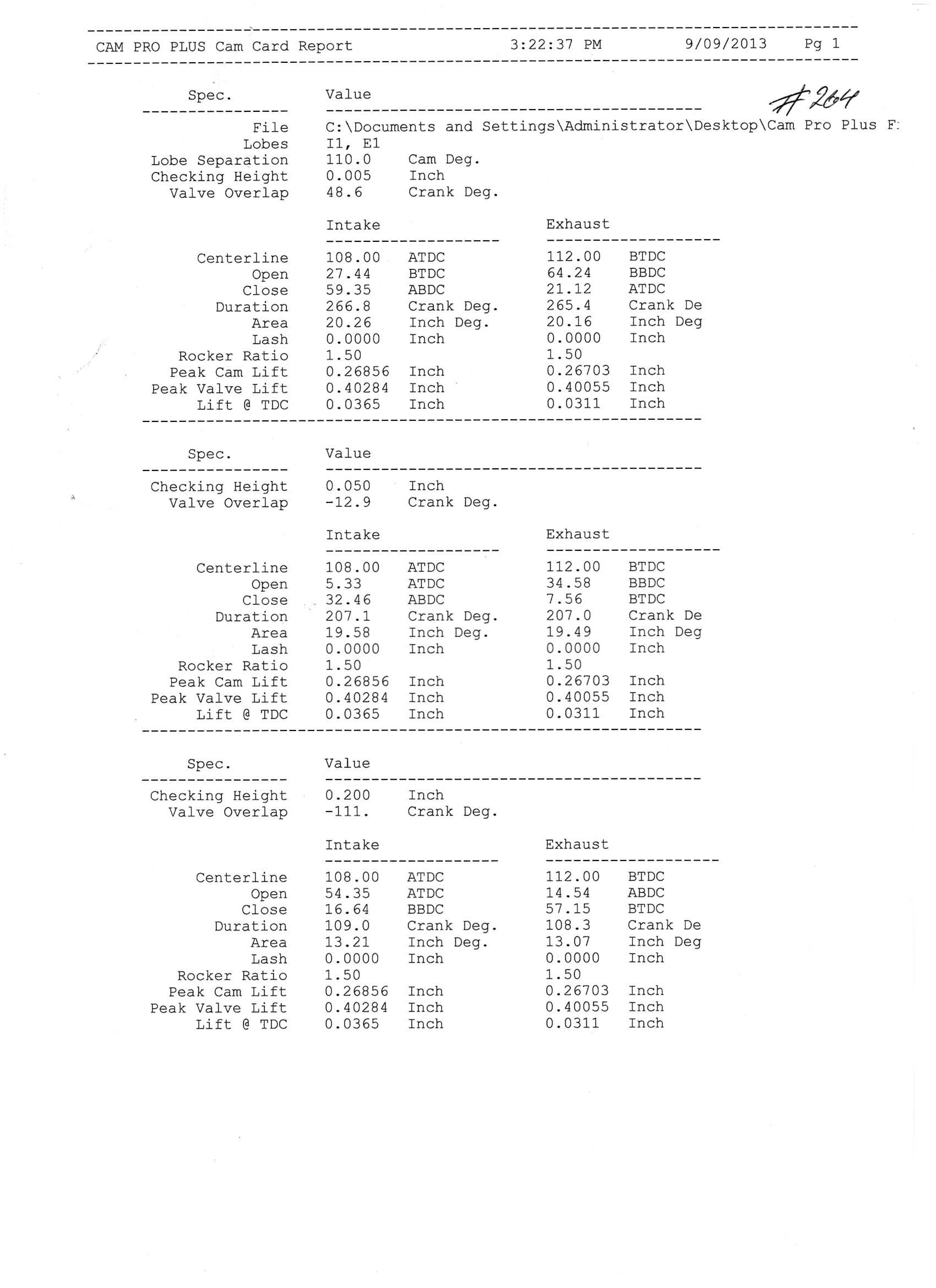

My project is in limbo while I move house so I'm doing some bench-racing. I have a 3.5 that I'm going to build up. The parts I have accumulated so far are a 9.75:1 short block, a set of reconditioned 4.6L heads, Edelbrock intake and Holley 465 carb (I also have a 390 at my disposal) and a new cam. I've attached the cam specs as I'm new to reading cams. The goal is to make the most of what I've got. So with a decent electronic ignition what would be a reasonable expected HP output of this combo? Cheers
