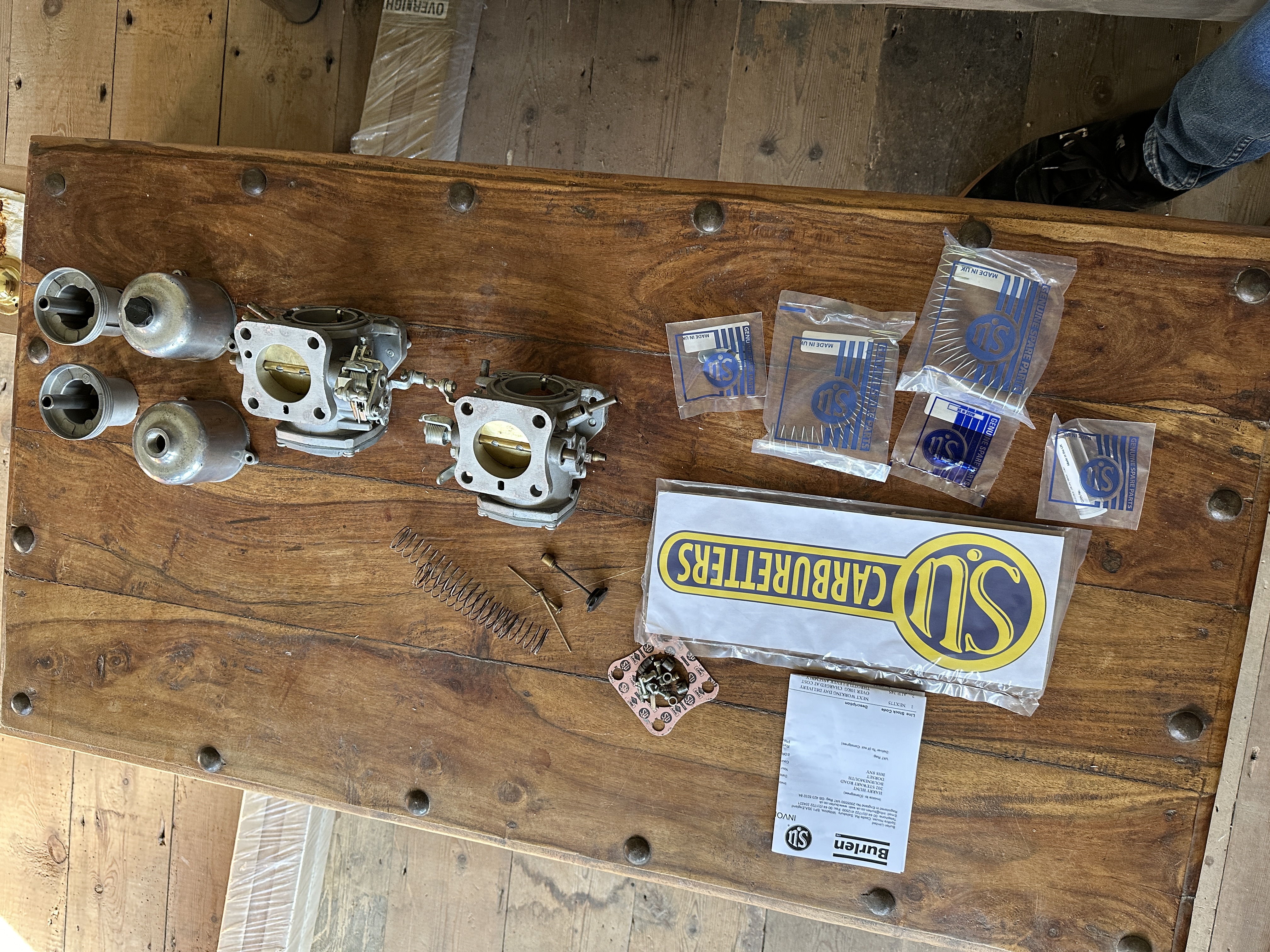

I drilled the back of my 4.6 block the same as the 3.5 block so it will vent the same. Having trouble getting the correct hoses for the SUs on mine and one of the hoses I did find new is actually hard, so going to have to find some alternative hoses. I was trying to make it look all original.

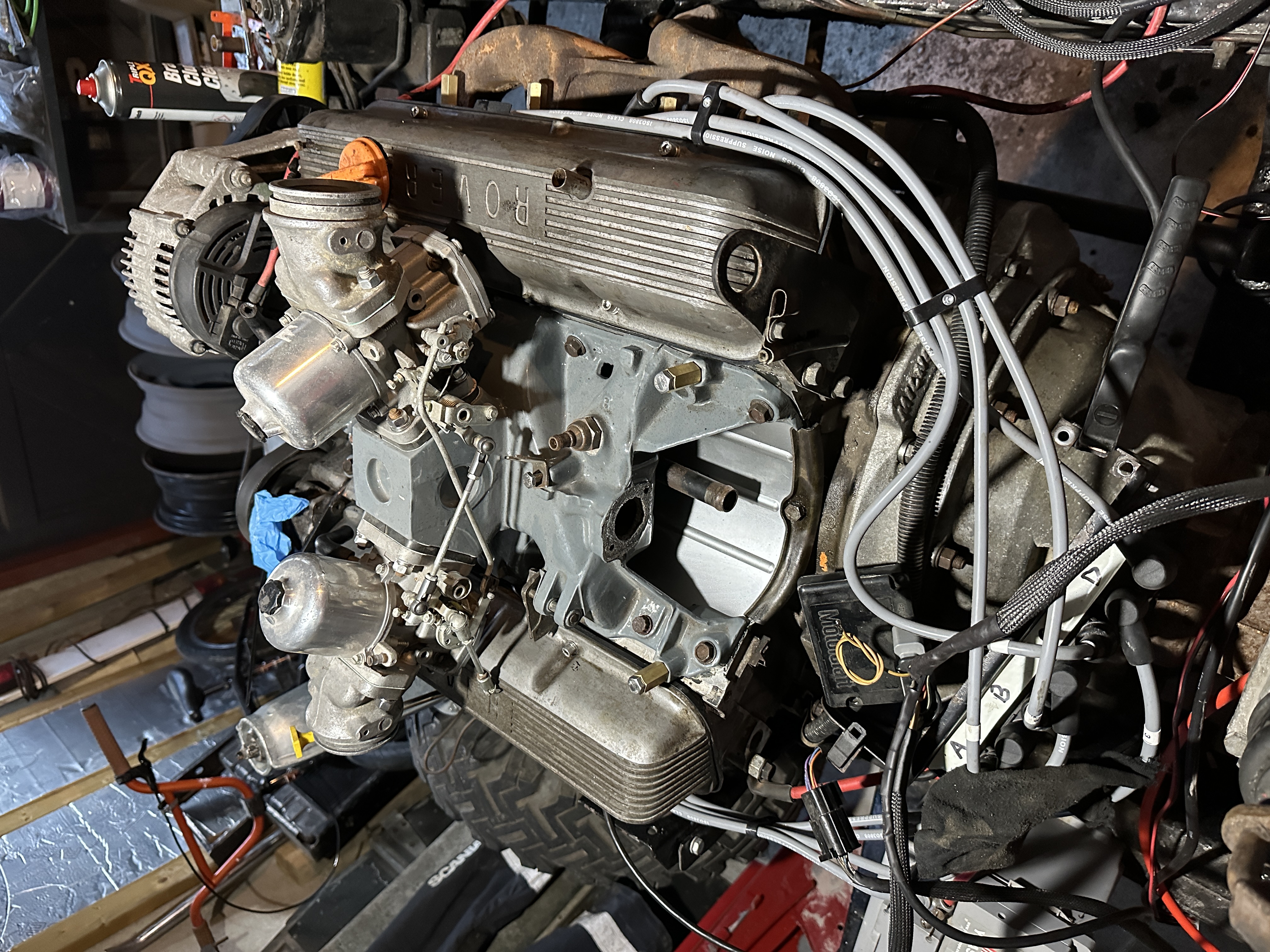

I’m going to joint both carbs with an old tin 3-port flame trap then pipe to one of the rocker cover ports, then the other rocker cover port I’ll pipe to the airbox.
Will need a restrictor in that airbox side pipe so the carbs draw a slight vacuum on crankcase.
Mine is a 4.6 GEMS with twin HIF6 and MJLJr going in an 80” landy.
