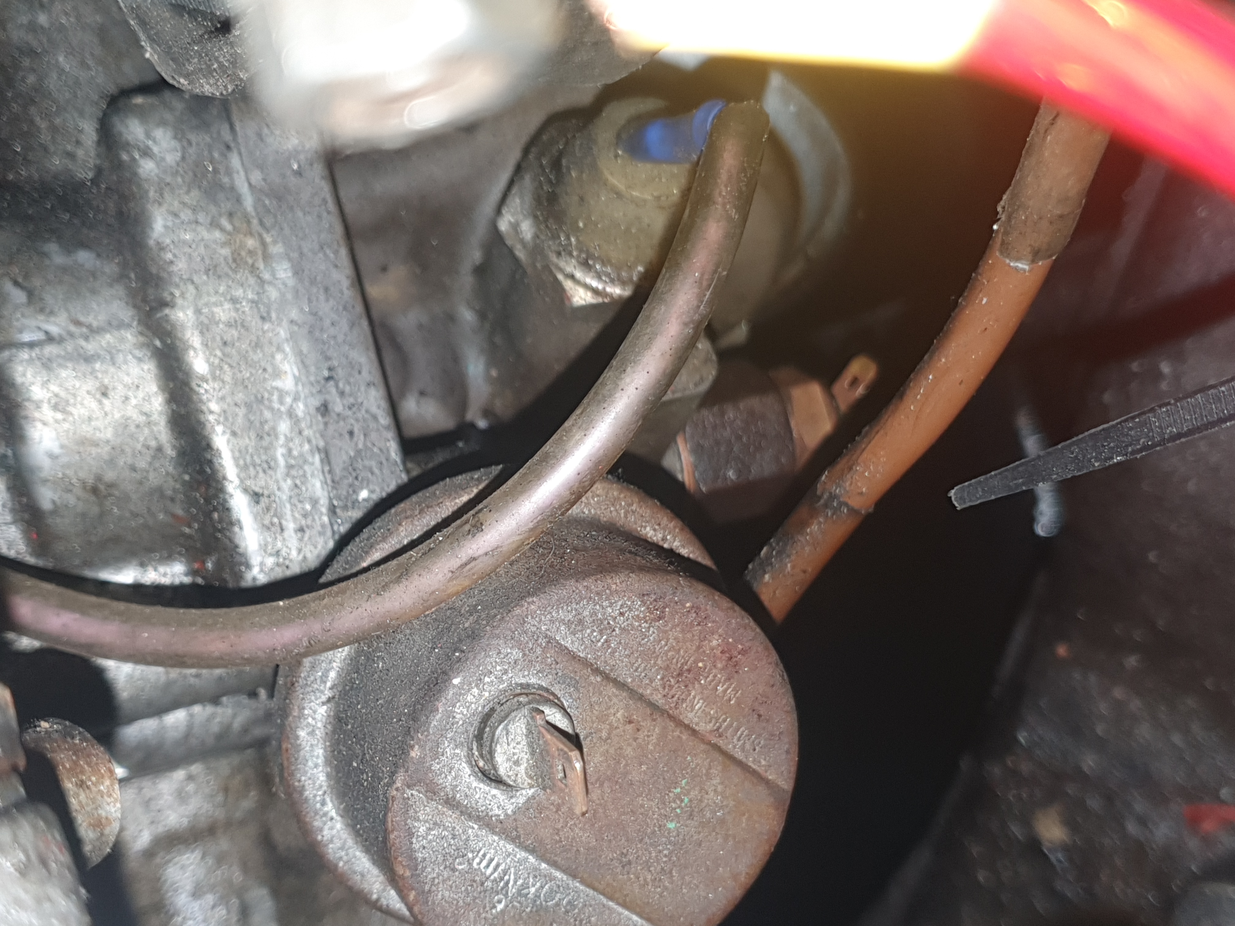

Well you've already tried 1 out of 3 spade terminals down there.
I'd try the farthest one first. The closest one looks like a primitive pressure sender, not a switch.

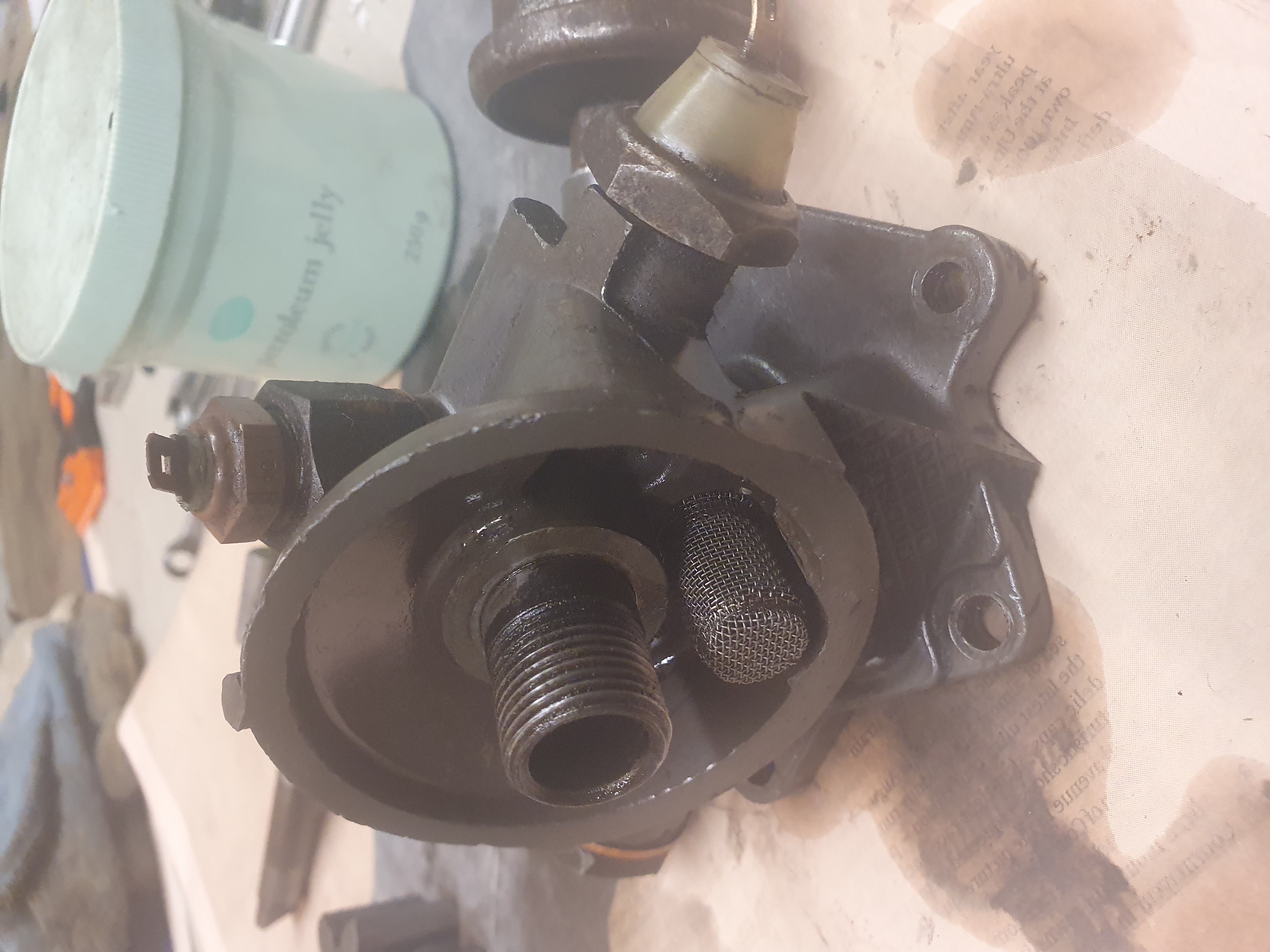

So, I have also removed and cleaned the oil pump cover and plan to pack it pack it with Vaseline and understand the importance of getting it in to all the nooks and crannies. I have also removed the oil filter and will top this up with oil when I put it back on but should I also pack the slightly domed area above the filter - see pic - with Vaseline as well ??

As you now have the pump cover off it looks like you're well on the way to a solution.Biffdiff42 wrote: ↑Thu Aug 03, 2023 6:49 am During the priming process the drill was turning in a clockwise direction and for roughly 3 minutes, but no joy.
I have removed the oil sensor from the oil pump and checked it using a multi meter and bike pump and the sensor works so this suggests a lack of priming in the pump.
I've tried the electric drill method several times in the past, even buying the correct tool, but never had any joy, every time I use the Vaseline method it has worked straight away. You mention in a previous post that the oil was out for a matter of months, this is ripe for allowing the oil to drain from the pump, mine was only a matter of days last time. Once you start spinning the pump (either using the starter motor or the drill tool) don't stop until pressure comes up.
You only need to pack the inards of the pump, from where you've taken the cover off, anything downstream including the domed area you mention is not necessary (shouldn't do any harm though).
Another thing is, although popular, it is not a good practice to pre-fill the oil filter. In doing so you are putting unfiltered oil into the post-filter location.
Admittedly this is very low risk but that is why it is advised against. In any case it will only take a couple of revolutions of the engine to fill up the filter usually before the engine fires.
