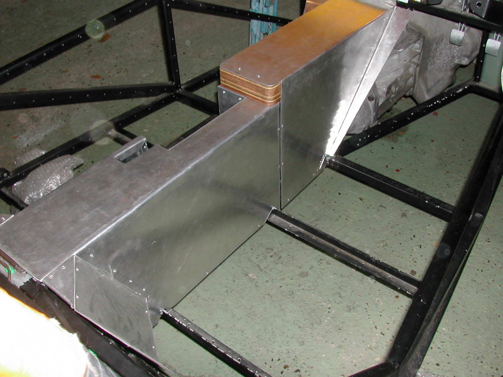

Anyway the fixing is very simple in a Rush but it is up to oneself to design you own fixing. There are two angle iron cross members where Dax themselves simply bolt through the floor. In my case I made up a sub-frame to which the seat bolts to and then the sub-frame attaches to these cross memberss. The front of the seat bolt horizontally via a tapped bolt hole in the vertical bit of the angle iron and the rear bolts vertically again via a tapped hole in the angle iron cross member's horizontal face.
You would normally only have four bolts holding the seat in. I'm surprised the carpet is bolted through as normall one simply tucks the carpet under the front of the seat touching the front cross member. I probably have more photos if you need them. You do not bolt the rear of the reat into te rea bulkhead.

Just looked at you photos again so I see the seats. Can only be bolted up from underneath into the cross members or directly into the seat bottom.
