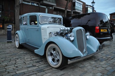

Here is my motor. I have been building the engine for about 3 months (collecting parts for as long as I can remember) It is a 1937 rover 10. It has a 4561cc Daimler Majestic Major Hemi V8. I have made the intake manifold to take 2 Stromberg 97's (2 are currently fitted). I am currently in the middle of adapting a ZF 4HP22 4 Spped Auto to the back. here goes:
The engine
http://i816.photobucket.com/albums/zz86 ... 89f7bc.jpg
The car
http://i816.photobucket.com/albums/zz86 ... b49990.jpg
The engine
The car

Hi Dave,
Nice work, often wondered why more people dont use the 4.5 Daimler engine, it really is a loverly looking lump.
nice bit of welding on that bell housing and done well with those oil pump bolts
Have look at these, a guy fitting a Daimler to a spitfire using a six speed BMW manual box
Another good example of jioning alloy to alloy
You have a great looking car for sure
Cheers John
Cheers John

Re: Rover 10 with 4.6l Daimler Hemi
Been on the road 3 years now
- ged
- Posts: 668
- Joined: Tue Feb 10, 2009 2:09 pm
- Location: North Wales via NZ
Looks great!
