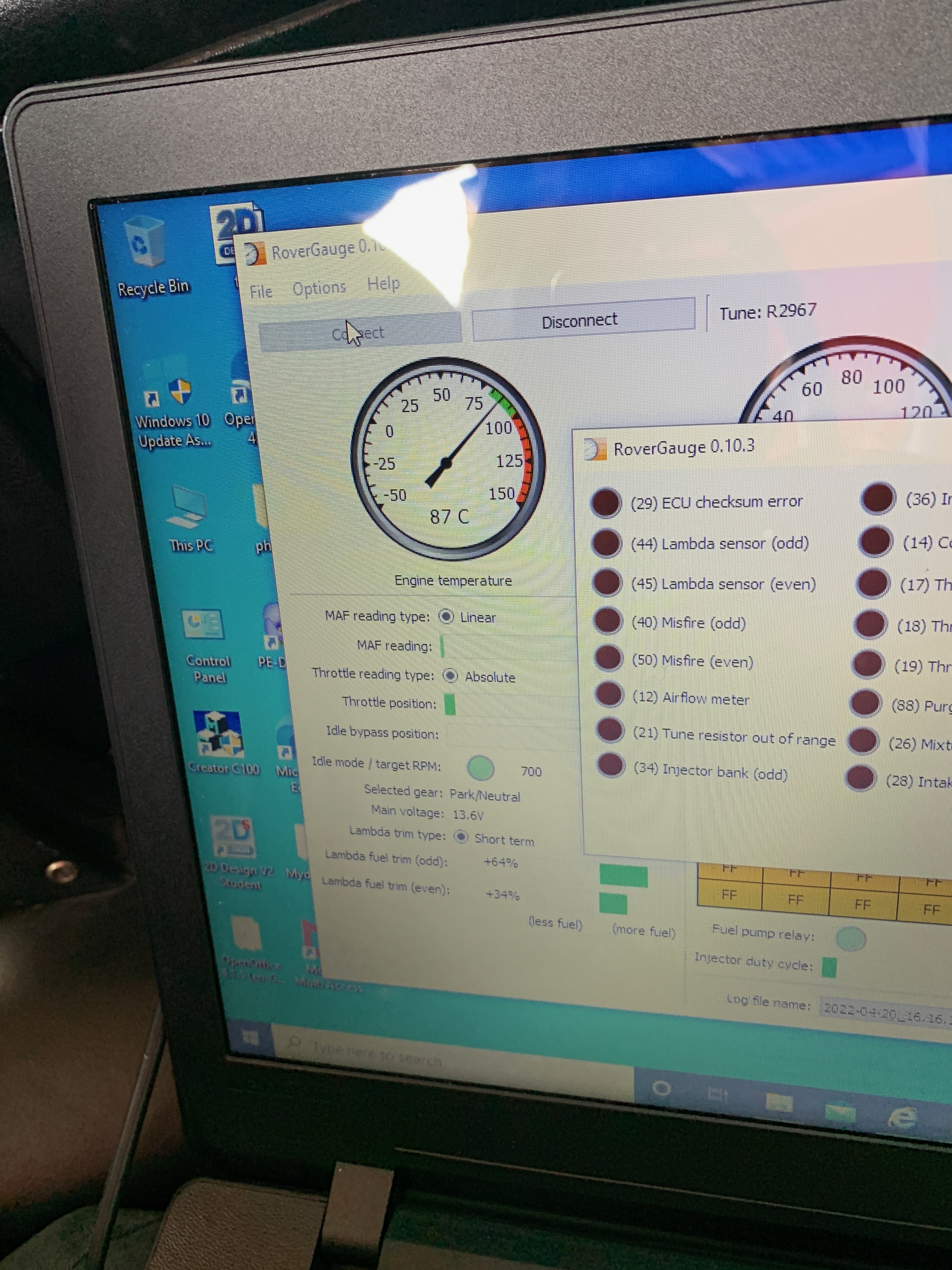

I have a 94 Morgan 3.9 injection with the 14CUX eco. it start and drives great but occasionally cuts out at idle. its been like this for about 18 months but its getting worse and not cuts out regularly.
I have rover gauge which had lead me down several false trails and I've fitted a variety of parts following 'advice' but the problem persists. I've fitted 3 stepper motors original, cheap Chinese and Britpart. The stalling continues. I've tried two MAFs original and eBay special (runs rough on this), still cuts out. I've set base idle, replaced fuel temp sensor (ouch!) and fitted new dissy cap leads and rotor arm (all from Morgan) and cleaned out the road speed sensor in the speedo cable.
Rover gauge points to this issues Stepper motor, speed sensor and error 69 NEUTRAL SWITCH. now I've eliminated stepper motor and speed sensor so Im left with the neutral switch which I understand on a manual is connected to ground via a 520 ohm resistor.

OK a little update - not that I'm expecting folks to be on the edge of their seats! I replaced both the MAF and Stepper motor back to original and immediately the idle became smoother and pick up from idle more assured.
Also the lambda reading dropped fluctuating around 40-60%.
However I'm now on the trail of fault code 69 - the orange/black wire with a 510 ohm resistor that goes to earth.
I can't locate the resistor but having disconnected the ECU and located the orange/black wire at the ECU connector end I get a reading close to zero ohms on a DVM. This must mean that there is either a direct to earth connection or the resistor has failed as short circuit.
Given that every failed resistor I've encountered before this one has failed open circuit I con only assume there is no resistor or there's a short to earth in the circuit.
As I've ordered 5 x 510 ohm resistors I intend to cut the wire and make my own connection to earth via the resistorMine reads zero ohms so I'm going to try to rig up a second wire with a known good resistor. eek!

The Neutral signal to the 14CUX is a little odd as it adds an idle speed offset to the basic idle, typically about 100RPM so you may have a basic idle of 700RPM but when this signal is sensed it will rise to 800 or something similar. The strange thing is how this works (or why it exists) is the signal is when the gearbox is in neutral or park, in these conditions you get the higher idle speed which seems the opposite way to what I would have expected.
Obviously this is not important as you are using a manual box so you should have the 510ohm resistor permanently attached in this case you would get the offset RPM always in effect hence the higher idle speed.
I've actually made a modification to my system using a pressure switch on the clutch in place of the auto gearbox switch. In this case I get the elevated idle speed with the clutch pressed and the 100RPM lower speed when it is released, this means I can have a slower idle (and hopefully lower underbonnet temperature) when the car is sitting idling out of gear but a higher speed when I put it in gear to as an aid against stalling, particularly useful when reversing.
When the car is fully warm what does RG indicate as your target idle speed? Also what did you set your base idle to?
EDIT
I just looked at your screen grab, looks like you have a target idle of 700 (engine up to temp) and it's registering in park/neutral so presumably the gearbox switch is grounded and you are getting the basic idle speed (presumably 600) and the elevated idle combined.

Thanks for taking the time to reply. I have previously driven the car with RG connected and it does show road speed so I assume it’s working. Mind you I also assumed the 510 ohm resistor was in place as RG suggests but measuring with a dvm suggests otherwise.
