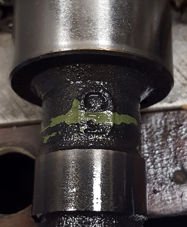

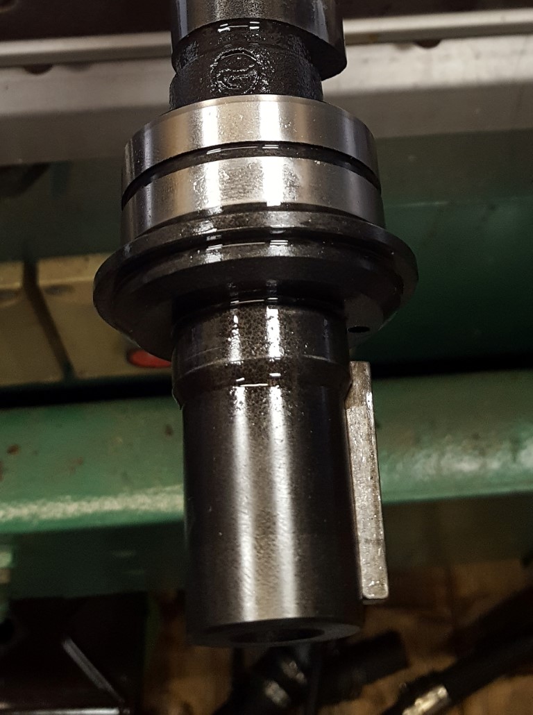

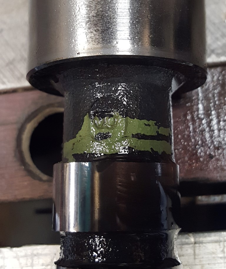

Some pics of the cam. Lift is about 6.8mm

Give John Eales a ring, they do look a lot like the rockers he supplies,
Ask him about the cam, most engine builders have there cams ground,and number themselves
You’re going to need new followers to go with the cam, ideally the same size as you have, otherwise you will need longer/shorter pushrods.

John Eales didn't recognize the cam code either! Very odd.

Well it turns out the blank is made by Estas. Waiting to see if they recognize the stamped code...

It was a stock 4.2 cam.
Bought another one from a landrover parts place, only £70.
Measured it against the old one. It's even made by the same company.
