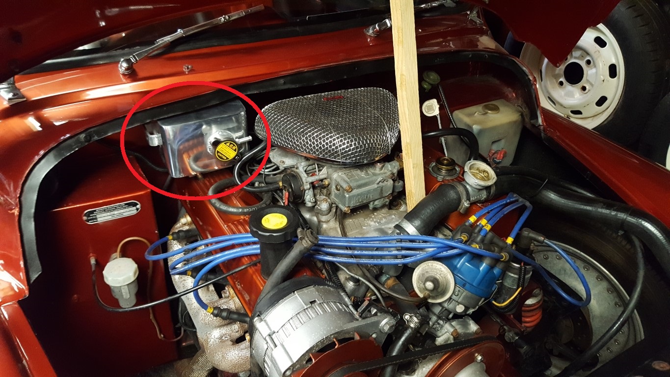

Here's the ideal location:
Just need someone to modify the tank....

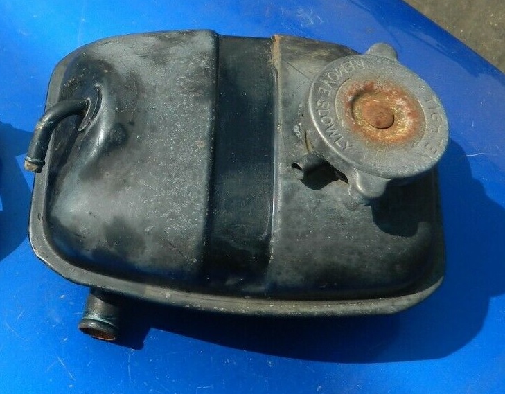

A TR7 one might do the trick, I think these are brass so will clean up nice. They are orientated the right way to slip into the same spot and have all the right pipes on.
Posts: 1285
Re: Adding an expansion tank to a RV8
The Classic Minis had a virtually identical tank, but it stood "upright" with the filler cap at almost right angles to that one, maybe worth looking at as an alternative for space issues.
Posts: 4112
Just draw a tank up and have it made, you can get custom stuff done like that fairly cheaply.
Seems plenty of room to have one sit on that box above the brake pipe stuff.
