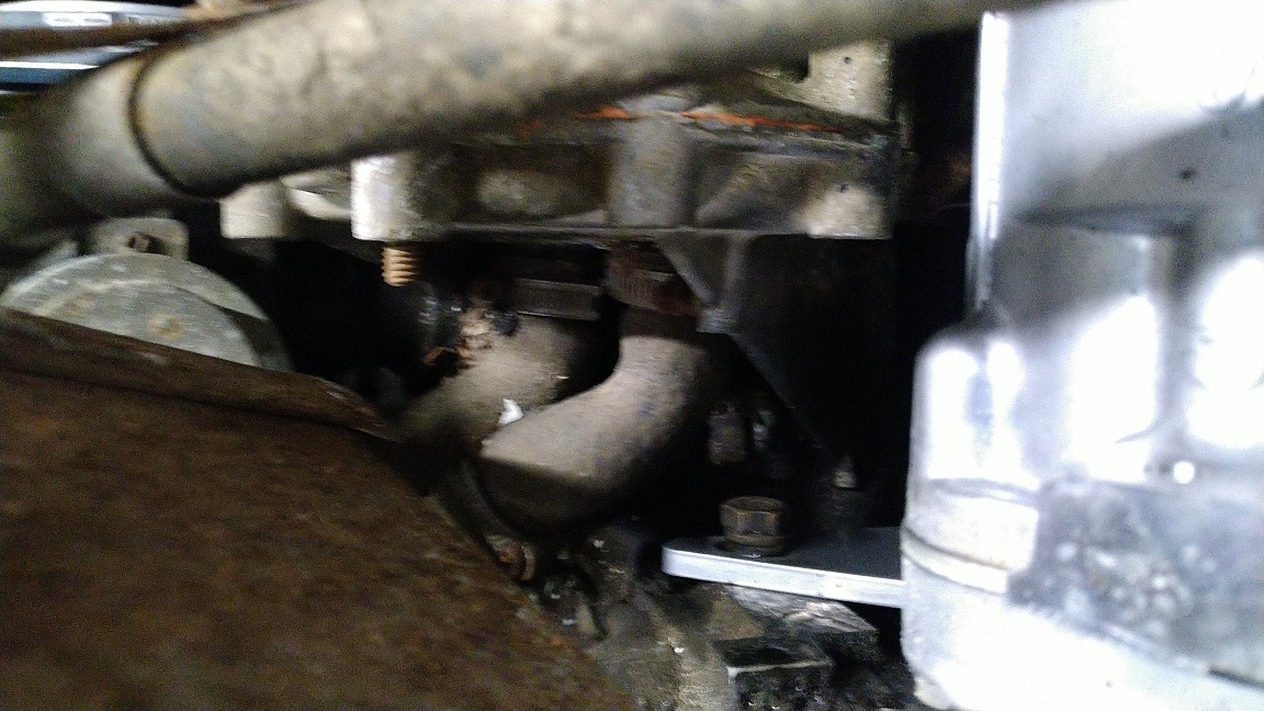

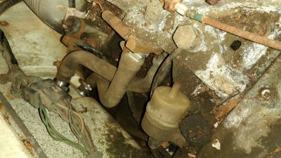

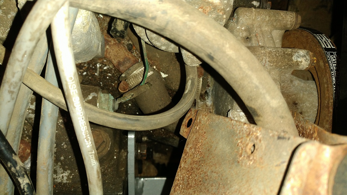

Hope this shows the set up?
Pat

Yes, that short pipe next to the thermostat housing is the thermostat bypass.
Your heater circuit exit's the manifold at the back, into the heater matrix, then the heater return runs under the manifold into the back of the pump.
So you are fine to shut off this heater circuit.
The centrifugal coolant pump won't be able to pull any meaningful vacuum so don't worry about that.
