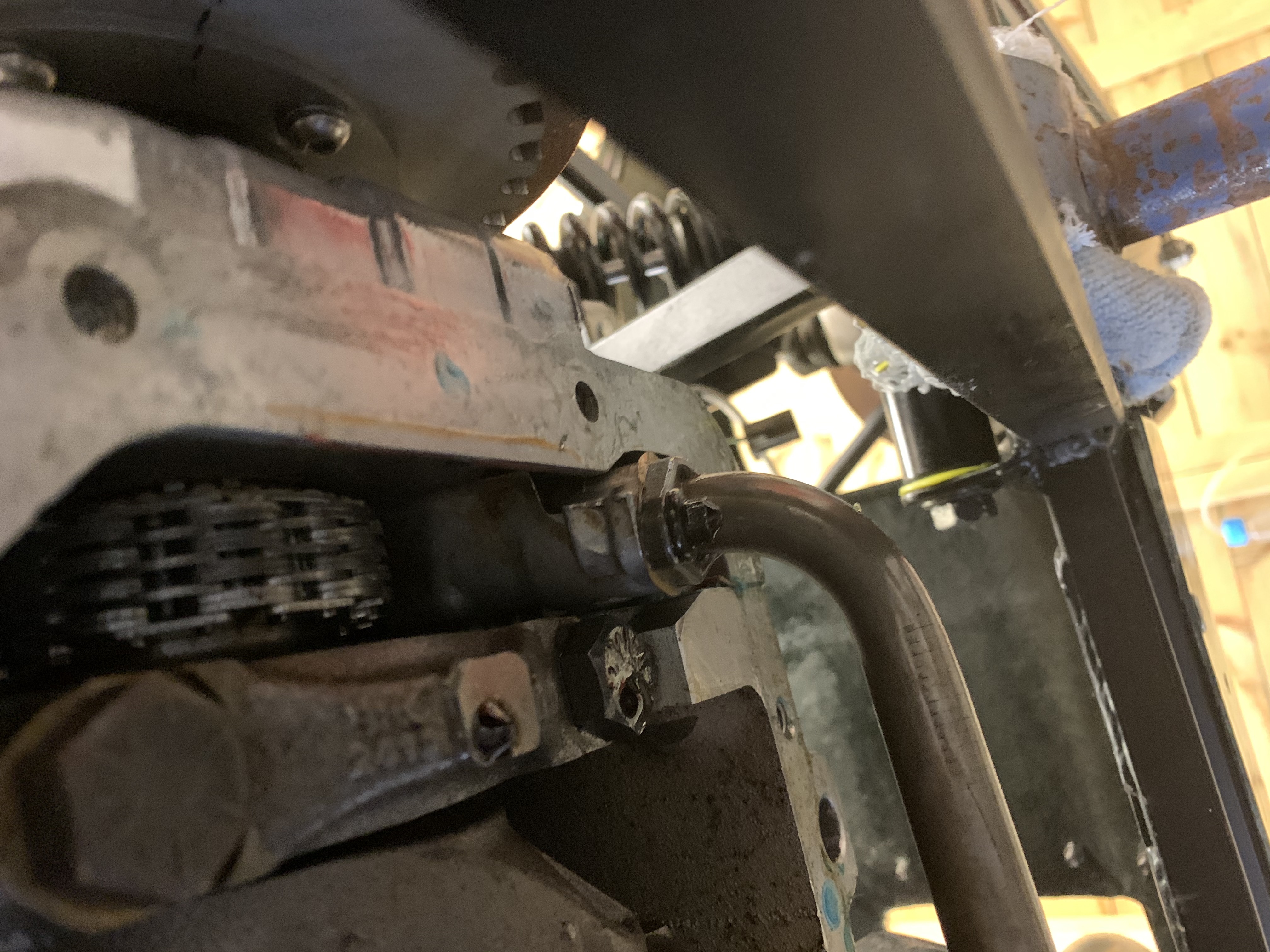

Anyone know the function of these (do they tap into the oil way?):
Building a westfield V8

Do not touch those - they are the cross bolts for the bearing caps and no they do not go into an oil way.jenko wrote: Fri May 15, 2020 5:08 pm Anyone know the function of these (do they tap into the oil way?):

I've now taken the sump off, to jack the pick up pipe, and all seems well... also took some closer pics of the alternative older style pick up pipe location...it definitely goes into an oil way, but I think the front cover acts as a block to this.

This is where the other oil pick up goes....so the newer style front cover with the crank driven oil pump, must go over it to block it off.
So I feel like I'm back to square 1. I think the engine has spun enough times now that I really would expect to see oil in the engine. im stumped, next step is of course removing the oil pump. The only other thing I can think of is the remote oil filter 'in' 'out' tables are wrong!.
