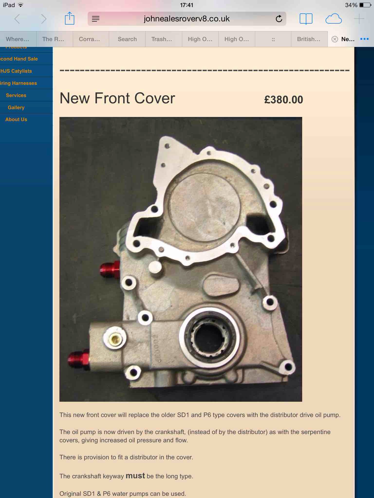

Go with one these front covers from John Eales
A far superior oil pump,distributor hole, takes a P6 water pump
