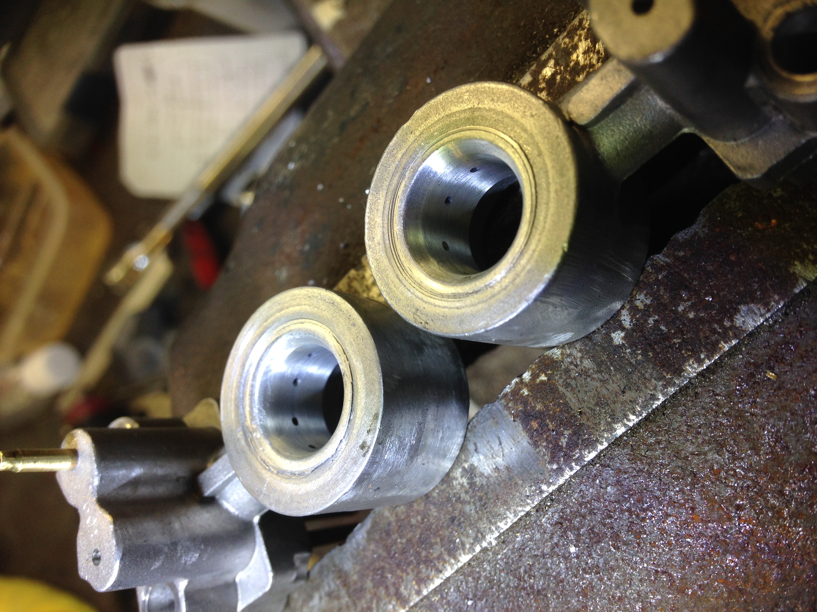

Re: Can I pass 1990 emissions in UK with a carb?
I've worked on loads of Eddy 4 barrel carbs, you can reduce the effect of them going rich when braking or cornering hard by making sure that the carb is mounted level, many manifolds tip the carb forward and that can make it spill fuel into the primary venturies when braking, fit a wedge plate if required. Even when new the float heights are never set correctly, increasing the float height by 2mm helps because it lowers the fuel height. You can not go more than 2-3mm through because the "spill height" becomes too large which messes up the carburation. Blocking off the passage at the back of the carb that connects the two float chambers also helps when cornering. Having said all that if you really know how to throw your car around a track then you can still get an eddy carb to misfire. I have always found that an Eddy carb will need recalibrating on any engine that I have worked on, they seem to be OK but are usually way too rich on the cruise circuit. If you manage to get the carb to work with a vac advance ignition system and the carb has been recalibrated then you can get very good MPG out of them. Getting these carbs to work well with any of the standard Lucas vac canisters is not easy, I had to open up the last canister that I worked on and modify the 'internals'.
My latest set of mods include modifying the standard straight leg boosters so that they are annular boosters, this allowed me to lean off my cruise circuit one full ratio. On Muscle Manta's SD1 which is currently running a stock-ish 3.5 we managed to lean the mixture off to at least 16.5:1 on cruise and it still responded to the throttle very well, it may have been happy going even leaner!
Edelbrock are making some carbs with annular boosters now, personally I think that they could have done a better job because I can tell from the jets and the rods that they have fitted that the 'signal' at the booster is not all that strong.
Below is a picture of my modded boosters...
