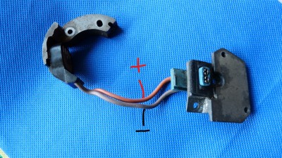

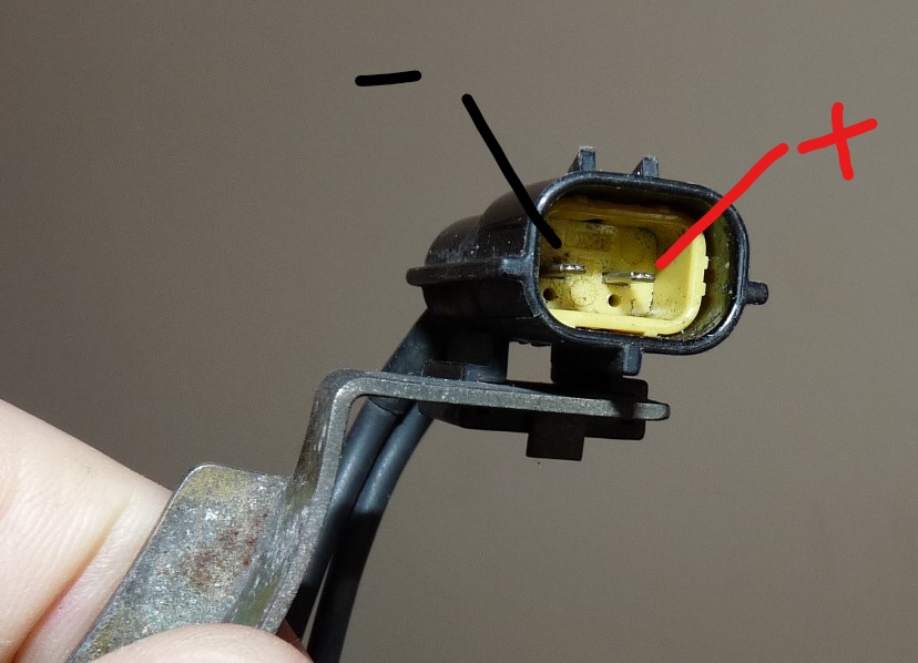

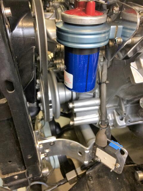

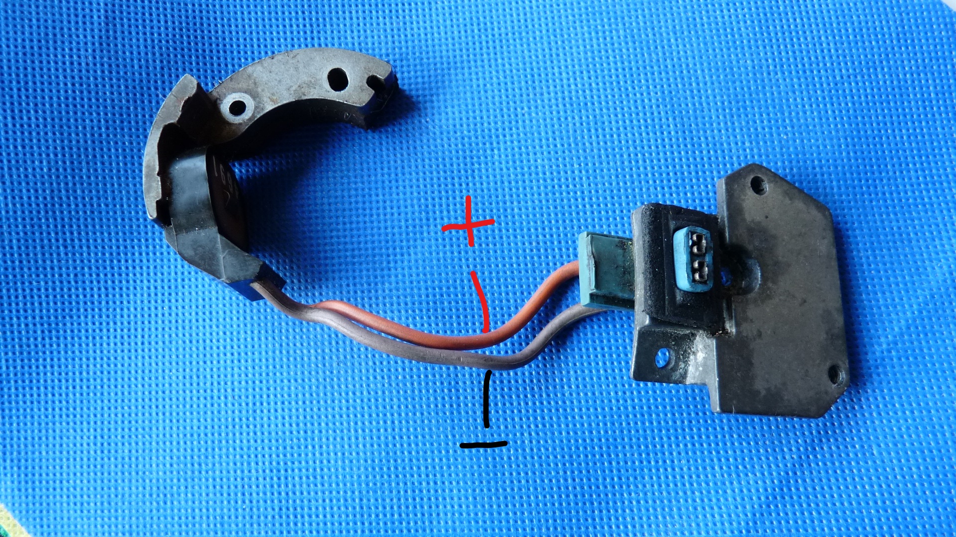

I have just swapped my old dissy unit for the later type in the lead post, put on a remote std plate low down in the engine department and bent it to be in the coolest part, I used a 12v 0.8 ohm coil, apparently the coil has to be under 1.5 ohm, I was looking to convert to the HEI GM type unit in this post but run into the same problem as the standard unit, that is most available seem to be made in the far east, found a "performance" unit here in the UK made by Proform, https://roadcraftuk.co.uk/index.php?rou ... uct_id=541 most US performance shops stock it but someone said in the reviews, although they gave it 5 stars, it had made in Taiwan on it !
I have included pics of the plus and negative terminals on both types of dissy for peoples info.
