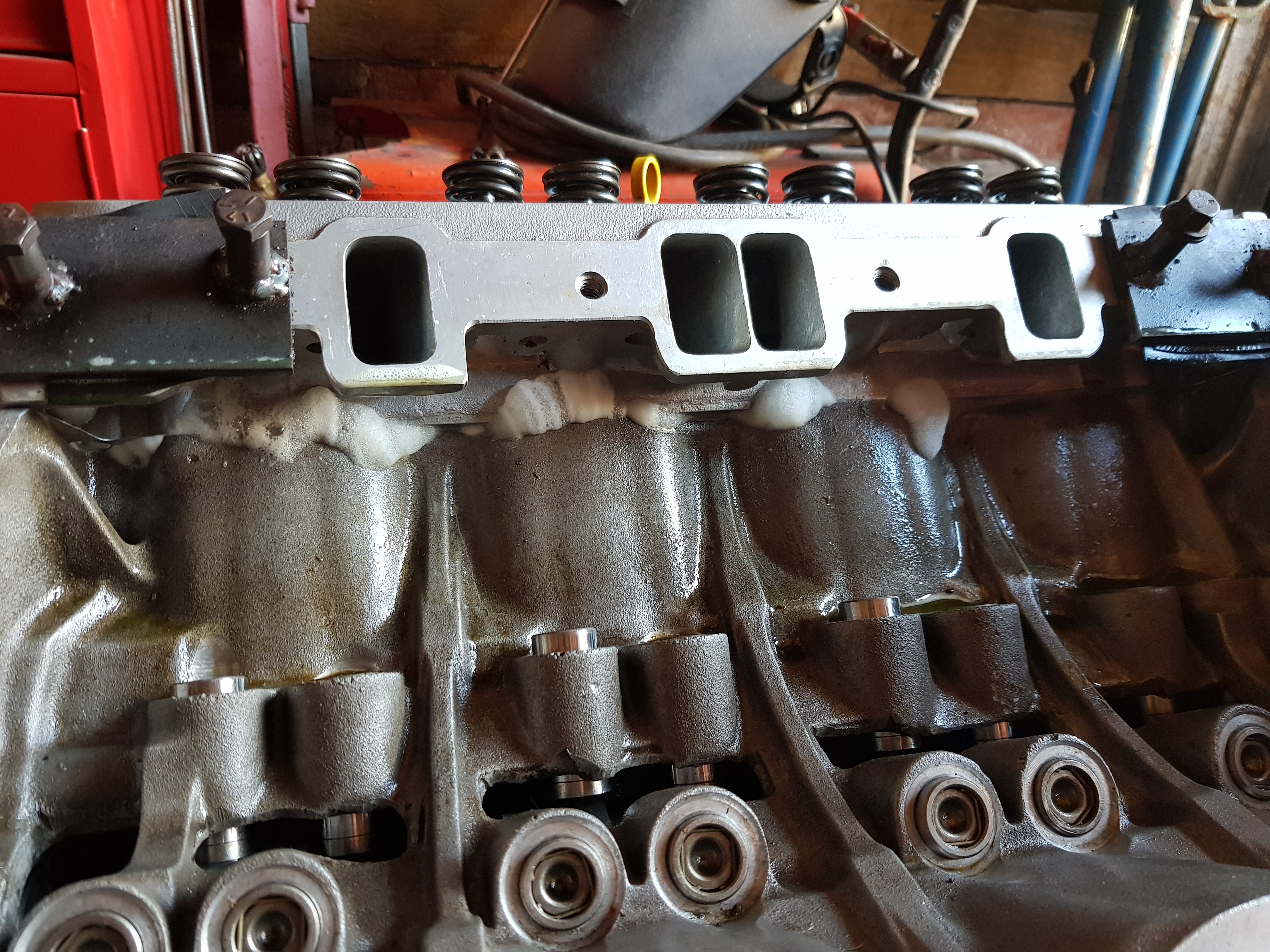

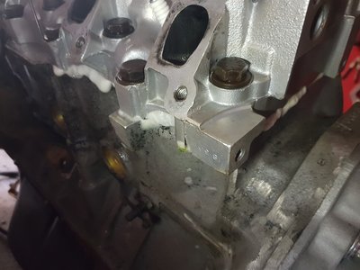

Hello I've spent a few months cleaning an early 3.5 and basically doing minor fettle jobs to refresh it, one thing that is causing a minor headache though is that the heads wont seal to the block at all!! I've pressure tested the heads individually and also the block to 80psi and could see any drop over night, however if I fit the heads to the block it leaks air all the way along the joint as if its somehow tracking along the gasket from the outer jacket transfer windows in the deck
I've tried both types of head gasket and they both do the same thing albeit the composite type allowed the jacket to pressurised the oil gallery even!
Has anyone come across this sort of thing ?

Just had another look and it almost seems to be leaking literally all the way around the edges of the gasket even bubbling out of the little v joints that the end seals for the valley gasket seat into !!

All this test gear has come about due to this engine upon first fire leaking coolant onto the exhaust manifold and also emulsifying the oil straight away, I pressure tested the block and heads as separate entities to rule out internal cracking etc and then added the heads to the block multiple times with differing head gaskets, the composite gasket allowed air to pass into the oil gallery and leaked from the front and rear face of the gasket joint, and the tin gasket allowed air to pass across the entire gasket , my feeling with this is that as the composite gasket was compressed uniformly and that the block deck and heads are straight (according to the ground edge of a long vernier caliper) that there are instances of gaskets with inherent faults and also the tin gasket requires the water jacket openings in the deck to be basically freely of any corrosion damage of any sort as the indentation passes really close to the edge of the opening and also I noted the raised indentations dont completely flatten so any leakage path will track around the gasket face unhindered.
