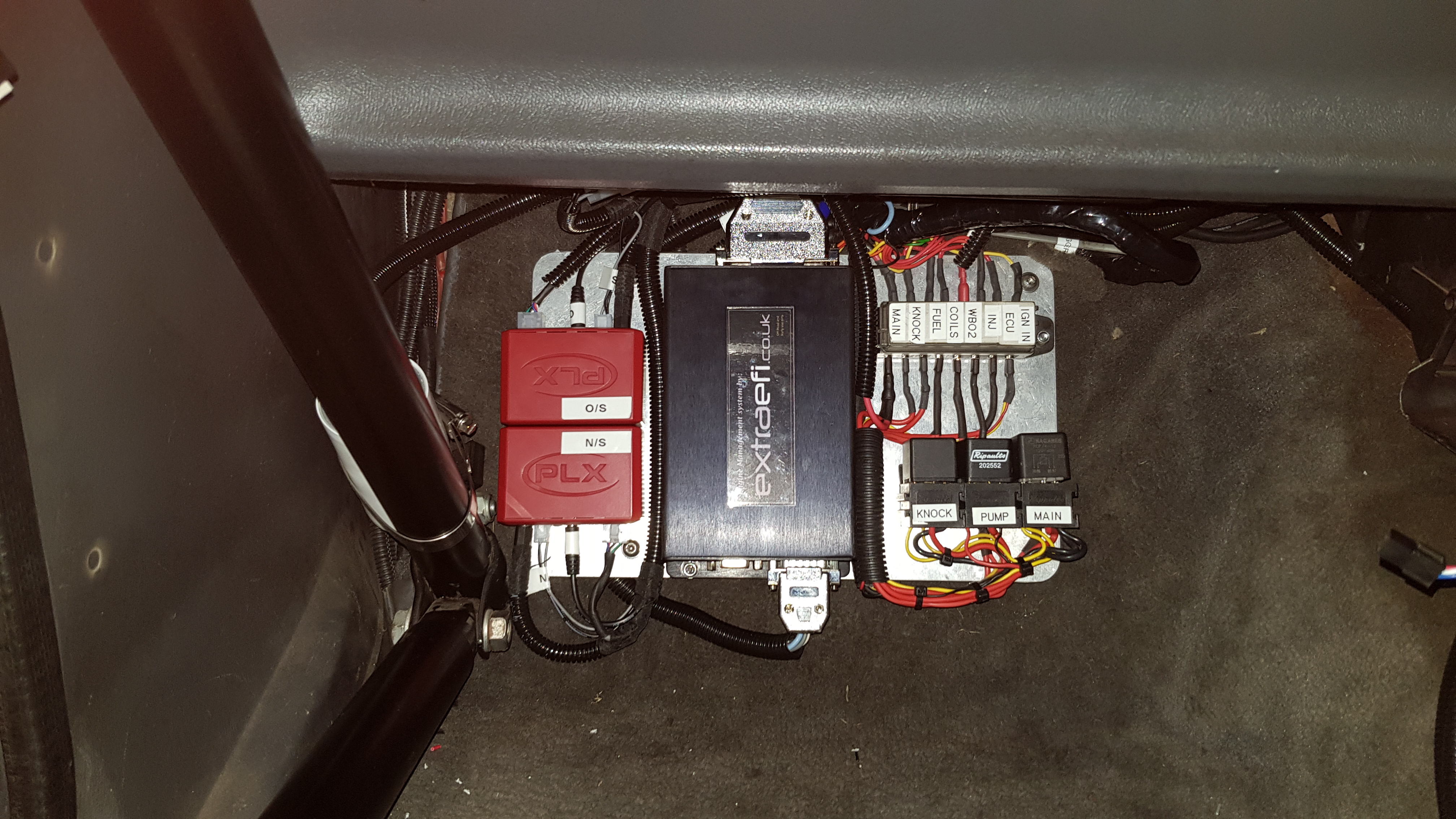

Well we finally have started to get everything together for the new charger to go on,
Procharger D1SC Supercharger and bracket (made by v8 performance parts)
Procharger v Rotrex
dual PLX wideband controllers to replace the troublesome Innovate set up im currently running

Have now binned the innovate and gone to PLX controllers and intelligent gauges.
