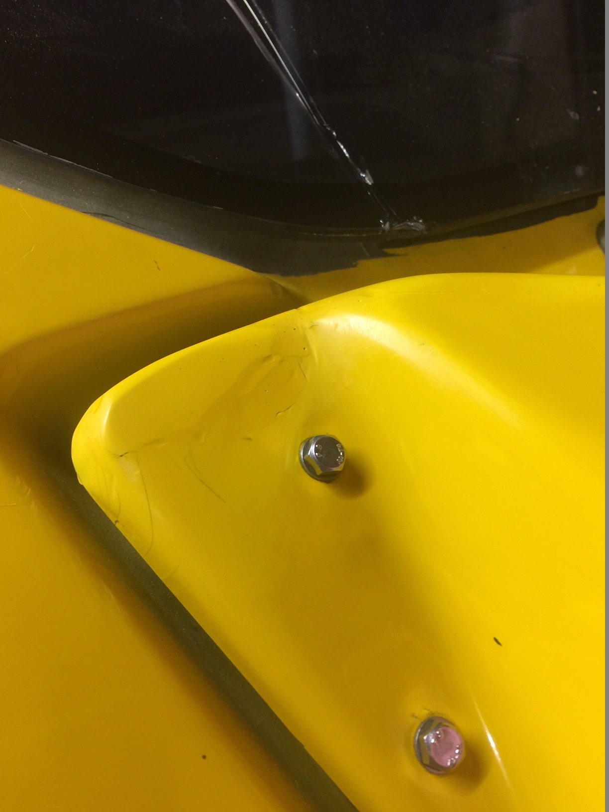

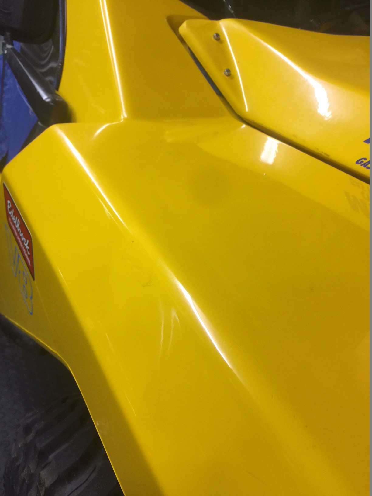

With a big thanks to Gelmonkey who very kindly provided me with some yellow gelcoat and fixer - I had a go over Christmas fixing the void in the side and the damaged lip near the windscreen.
I'm sure Paul is probably rolling his eyes at my poor workmanship - but i'm over the moon compared to what it was like before!
Few questions:
How long will the gelcoat stay workable in the tub, as I've got tons of it and only used a tiny amount so far.
And I totally guessed the amount of fixer which I randomly seemed to get right, I could do with a more scientific way to make up small batches like this so I can fix the rear arch next.
