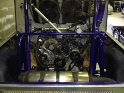

I have a 14CUX ECU on my 3.9 Rover V8. I’ve had to do a little rewiring and have come a cropper.
I have a yellow wire leading to the ECU plug which I have traced to be pin 6 (Speed transducer). After doing some research I’ve worked out this is a variable voltage pulse signal to the ECU. My vehicle does not have or require any sort of speed sensor so I wondered what the importance of this signal was and if it can in any way be replicated.

Thanks for the reply. The vehicle is never likely to see a junction, only a Welsh logging track! The 6 pin connector was previously wired to an ignition 12volt but clearly this was not correct. The engine has never stalled but does have an unsettled high idle (revs will sit at 1500rpm but roughly every minute drop to 800rpm for a few seconds).
