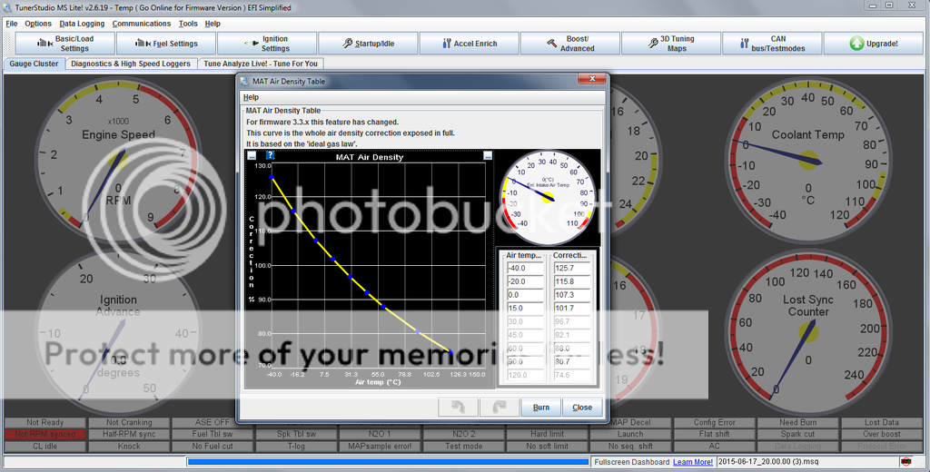

Does your GAIR look anything like this MAT density correction?

So it looks like later firmware has done away with the two settings I have:
1. a single % measure for how harsh it applies perfect gas law
and
2. a table based air temp correction
Which makes sense i guess. My temp corr table is all zeroes so I am just using the gas law %. I assume that has its own table which is probably setup like that in Toms screenshot.
The corrections in Toms graph definitely seem to match the Gair figures I logged eg. 91 @50c.
Just to confuse things (i.e. me) my cranking pulse adjustment is all default (i think) and scales down to 101% by 71c coolant temp. I hope that doesn't need changing too or i'll probably go mad.

Any MAP based ecu will use a table like this to calculate the air mass entering the engine. Uses Air pressure and temperature to calculate air mass. Obviously depends on having an accurate air temperature reading and not an inflated heat soaked reading.Isn't that air temp correction used on boosted engines as the air temp will have a huge effect on the actual volume of usable air going into the engine therefore if its at a high temp then the fuel needs to be reduced as well to stop it running rich?
Not something that would really need to be used on a NA engine is it?
