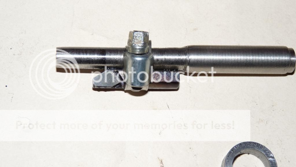

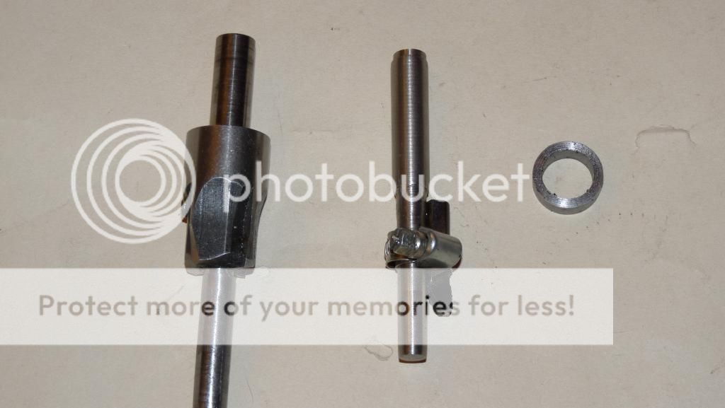

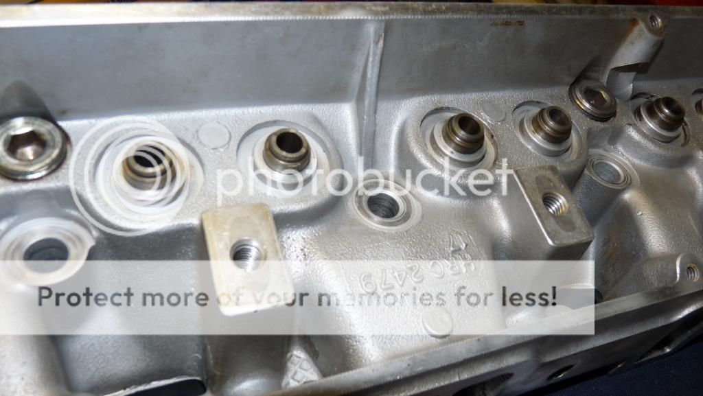

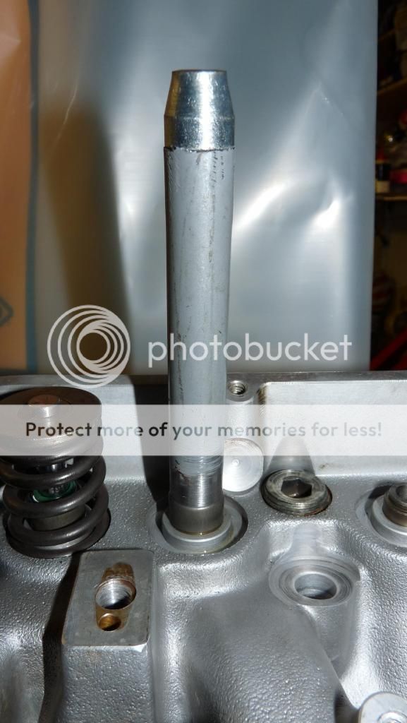

This is what I done in the end !
I made a spacer out of a bit of gas barrel to slip over the valve guide so that the cutter stopped at the required height , then made up a chamfer tool with a tiny lathe tool jubilee clipped on ! I then found the Vauxhall/Opel valve seals were too long, put them in the lathe and took 2mm off the bottom, made up a tool to drift them on out of a bit of door panic bar tube ! they were very hard to get on even with the drift and oiling first. a lot of fannying about, but its done now, only cost was the valve seals.

Good looking, neat work!
I like the tooling you made, too. Very well thought out.
