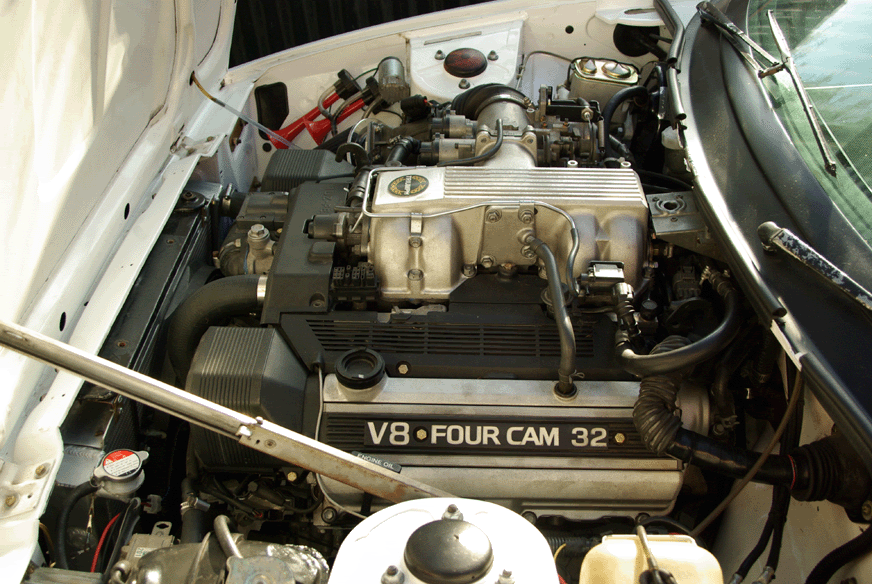

Hi Iain,
Sounds like a great project, but then i guess i am biased !
The BMW V8 is wider than the Rover V8 ? and dont forget the liner problem with the M60, we changed hundreds of them back in the day but poss still some out there that were not changed.
i know a few gents in Oz who have changed to Lexus V8's
Also a couple of guys in the states with yank V8's but at a guess heavier than the Rover lump
http://www.lanocharacing.com/index.htm
Cheers John
Cheers John
