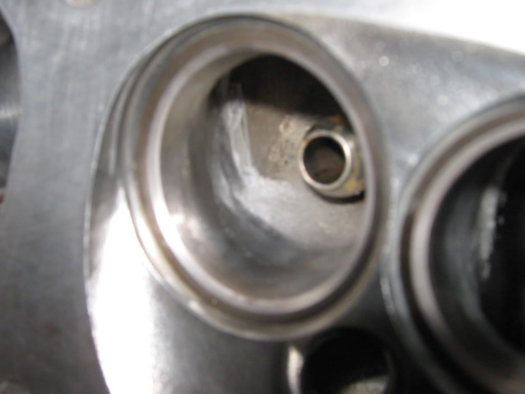

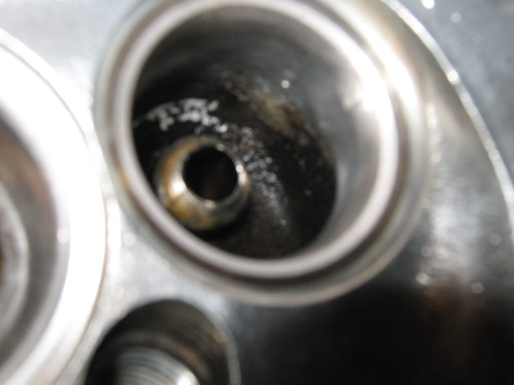

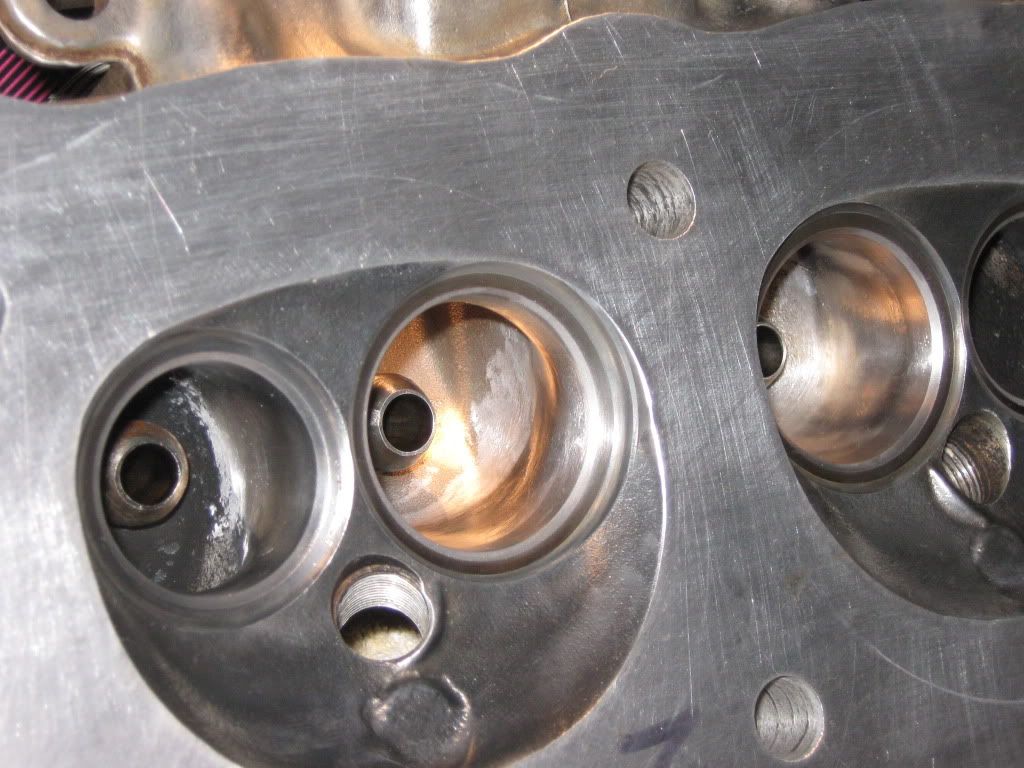

Hi guys
Just trying to post a couple of pics of my ten bolt heads now ive just about finnished 'pocket porting' them. If anyone has further advice as to impovments I'd love to hear from you! Sofar I have just opened up seats and smoothed the first inch or so or the port after the valve and bulleted the std guides as they were mint. I will add a few more pics if this one comes out!

Post by bclancy »
another pic

Post by bclancy »
ex port

Very, very, very nice! I'm a tad limited as to what I can do as I'm trying to keep as much bottom end power as poss, hence only working the area just before the valve to keep gas speeds high. I have only 'bulleted' the ends of the guides rather than grind them flush as your father did as I'm running LPG and was worried about the reduction in cooling of the valve. Am I being over cautious? As I'm new to the RV8, plus its going in a heavy ol Disco I didnt want to go too far, especially as I have decided to run with a stock cam at the moment (my aim is to get best power around 2000-4250RPM as its an auto and thats where she spends 95% of the time running!
I have so far avoided the temptation to clean up the ports further down as I'm not sure it would help and may well cost me some midrange grunt?
Any thoughts anyone?
Brian

Brian,
Looks good and basically a stage 1 head job, should show useful gains in the region of 30 BHP on a 3.5 though would help to see a clearer pic of the transition from the seat to the throat.
A bit more compression would help with the LPG so you could have 20 thou off the heads for approx +.5/1 making 9.85 if fitted with high comp pistons and tin gaskets.
If you skim the heads you will need to check the lifter preload and shim the rocker pillars which is ok with a standard cam.
Kevin.

slightly better pic of inlet
I have left the port runners alone as the ten bolt heads have a slightly larger port already against the EFi/vitesse heads
The BLOS variable ventury mixer (think LPG S.U. Carb!) should make a big diffrence compared to the old mixer ring!
Posts: 4081
Most important, although cant be seen in pics. Is a smooth radius on the sort side turn.
basically smooth turns everywhere. No sharp turns. Overall shape can be important, but for simple stuff...just smooth !! polishing isnt important either.
As for the guides. The last ( expensive ) RV8 heads I had, they just bulleted them too. They said guide shortening made virtually no difference to airflow so wasnt worth doing.
