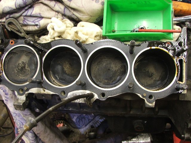

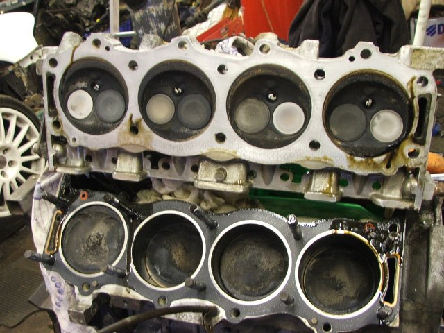

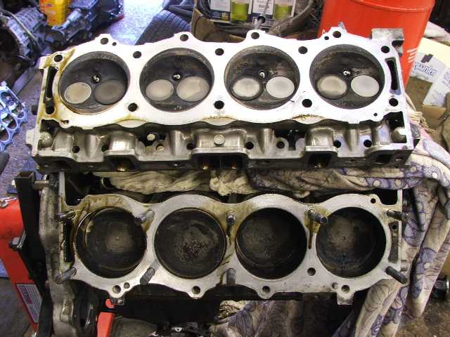

right heads came off today and nothing looks different to all the others,
will post pics up shortly.
Passengers side:
And with head:
Drivers side:
had a closer look today and the port is not clean, the carbon etc is white same as the exhaust valve faces,
