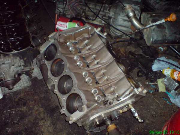

The block:

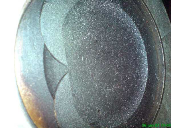

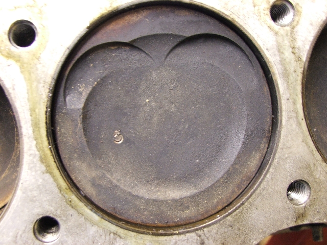

The 95mm pistons with two valve cut outs not four:

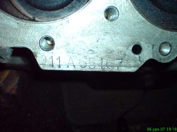

Engine Number:

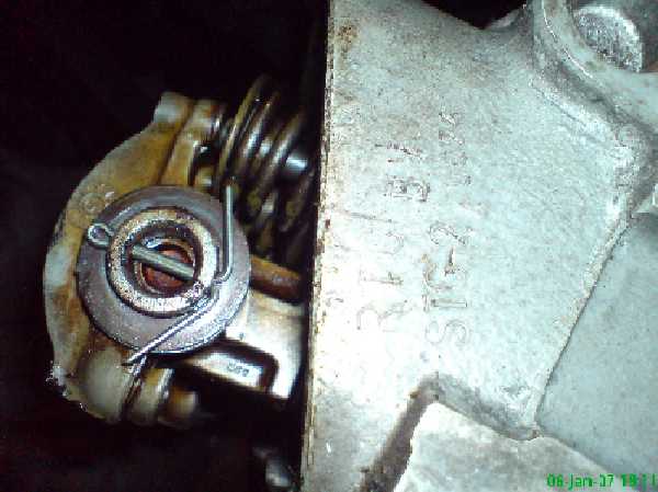

Rtec stg2 heads.

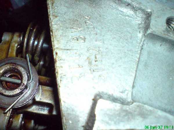

The engine is,
71.12mm stroke,x 95mm bore .= 4032.91cc (246.1 ci) or 4.1????

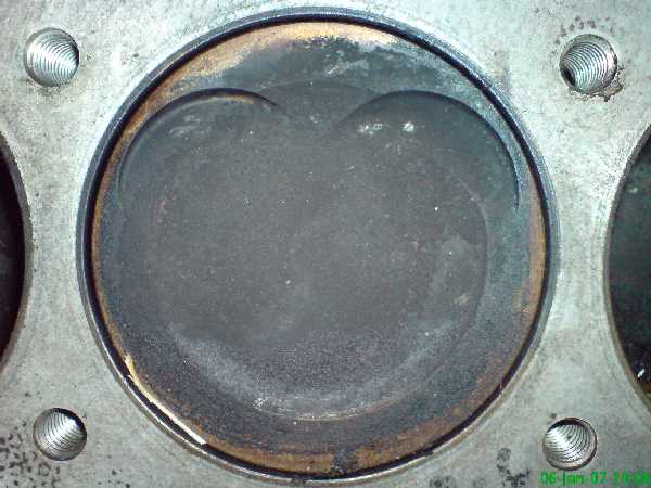

All 8 pistons are black not steam cleaned as if it was pressurising the bore,
could one of the heads be susspect???

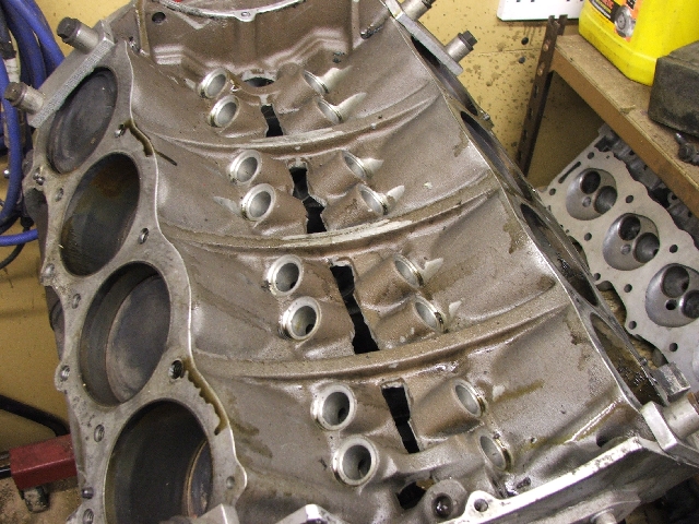

Also can we make up some sort of set up to pressure the water ways to see if there is a leak on a liner or on the block and heads???
we were going to blank off the water way on the block face with a plate and gasket with a pressure gauge fitted, and fit a plate the other end of the face to block it off and then fit another plate with a valve for the air line at the block front (water pump inlet),
if this is ok what pressure do we have to test it too and over how long to see if a drop??
we will do a similar thing with the heads then,
the other block to the left of the rovertec one is another 3.9 which if the RT engine is buggered will use this as a base to rebuild the RT engine into, :P
I hope to have both engines here in the week when i will strip th RT one down to a bare block and test if we can or send away to be tested.

As for pressure testing the block what you propose should work. Stand it on end and get all the air out of it. Biggest radiator cap is about 15 psi so I'd suggest that testing at that pressure would be ok but wait a while for leaks. Or, test at a higher limit and don't wait as long :)

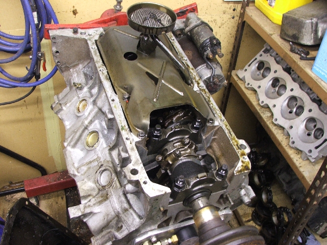

Neil delivered the block last night (tuesday),
and tonight (wednesday) started to strip it down ready for pressure testing to see if it has a liner problem,

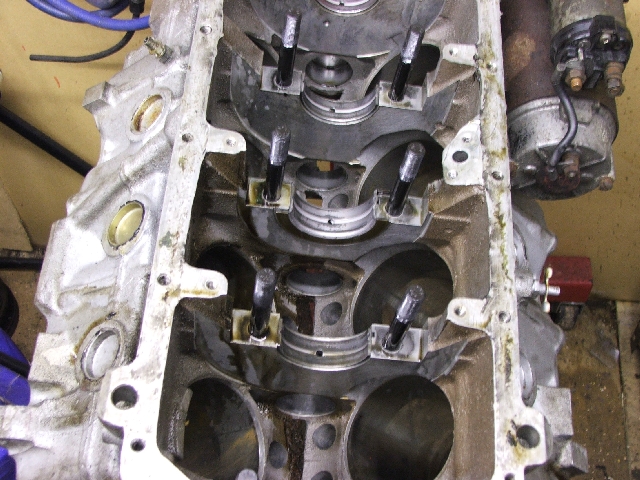

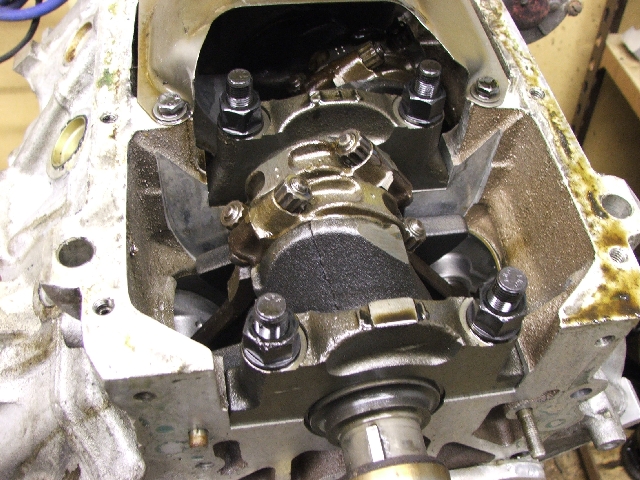

As you can see the block is very clean inside,
and to my surprise when i removed the sump it has ARP main studs, (one less thing for me to get 8) )

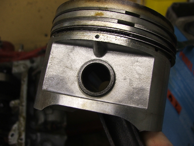

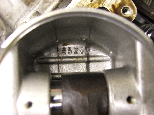

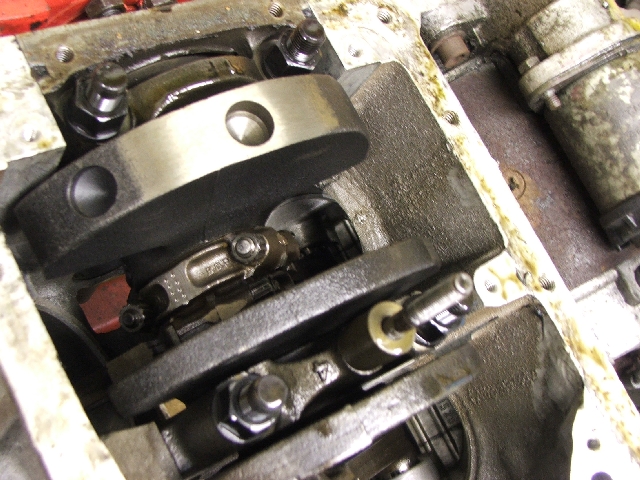

Do you think the crank etc has been balanced?? as there are a few polished marks (shiney metal) on the crank and some fresh drill holes (as in picture)

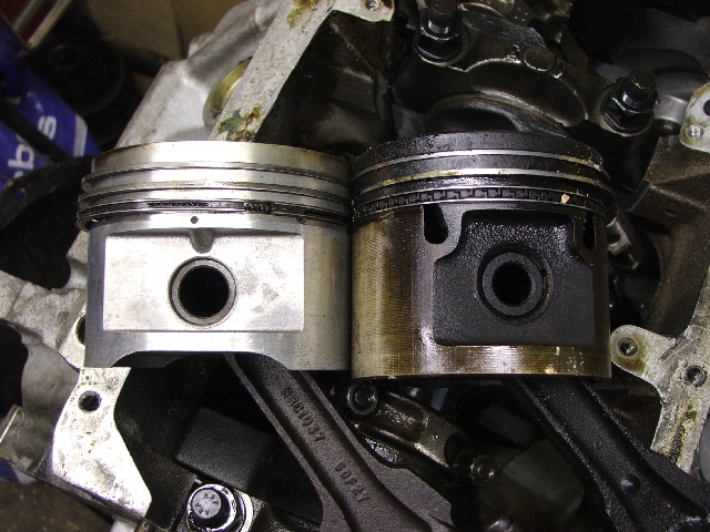

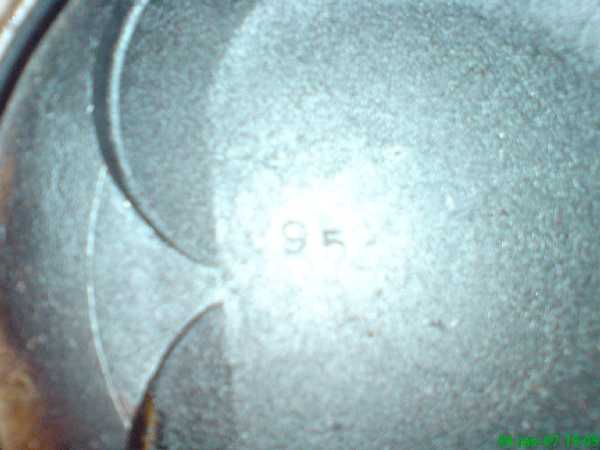

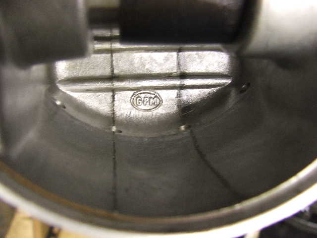

And has anyone seen these pistons before???
only markings are as in the photo's
9525 and GPM

Pistons are quite primitive, defo not Cosworth items. Look like cheapies to me but they will be up to the job, just or wouldn't have been fitted. Could be Silvolites or another brand of eutectic. They're certainly cast, not forged. Oh, here they are.
http://home.clara.net/captain.norton/cnn3sec35.html
Bit crappy for really performance use as are hepolites. Mind you, I do see pin oilers there so that's a plus :)
As for pressurising the block, go for a high pressure for say 5 minutes. How high can you go? If you don't get a leak then, you haven't got an issue. In some ways it's more likely the combustion chamber will pressurise the coolant, just imagine how much pressure there is in a cylinder at tdc.
cheers Mike,
all i can find are bike pistons by GPM lol.
so they are cast then, hope they can handle some nitrous,

My crank and rods looked the same as yours after it had all been balanced so i reckon yours has had the treatment too. Are those arp bolts in the rods?
