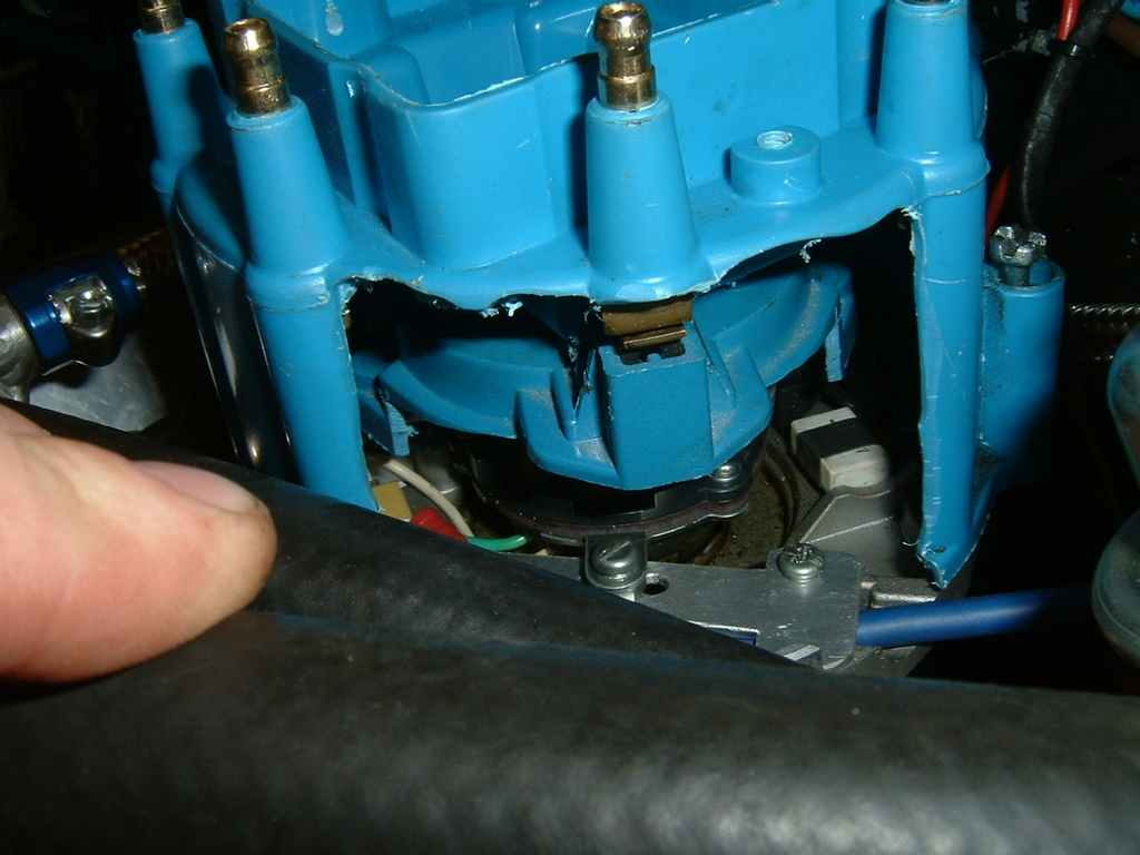

Wrt to checking the alignment, you could always just cut a hole in the side of a spare cap to see whats going on.
http://www.mez.co.uk/dcam/DSCF0330.JPG
It is quite possible to have the leading edge of the rotor in line with the post initally and then have the trailing edge of the post in line at full advance. That is why the brass strip is fairly wide.dwgriffith wrote:It may seem like a great idea to ensure that the posts line up with respect to the trigger rotor points, however, the vacc advance unit moves the base plate (which has the rotor fixed to it) round to vary the timing. This action will negate any attempt you have made to ensure it's firing position?
In practice this is quite time consuming to get right and I may have even got what I said back to front! It was ages ago when I did all this.
