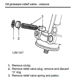

The oil pressure relief valve circlip is just above your oil filter.
Remove, clean, check your spring length and then re-build - maybe a job for the winter if its working ok now?
oil pressure relief valve.JPG (22.27 KiB) Viewed 14645 times
Oil pressure relief valve - inspection
1. Clean relief valve components and piston bore
in timing cover.
2. Check piston and bore for scoring and that
piston slides freely in bore with no perceptible
side movement.
3. Check relief valve spring for damage and
distortion; check spring free length:
Spring free length = 60.0 mm (2.4 in).
Oil pressure relief valve - refit
1. Lubricate new ’O’ ring with engine oil and fit to
relief valve plug.
2. Lubricate relief valve spring, piston and piston
bore with engine oil.
3. Assemble piston to relief valve spring, insert
piston and spring into piston bore.
4. Fit relief valve plug, depress plug and fit circlip.
5. Ensure circlip is fully seated in groove.

There are 2x springs and plungers.
One is the oil pressure relief valve from the oil pump.
The other I think is to do with the oil cooler from memory.
