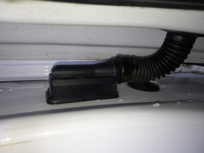

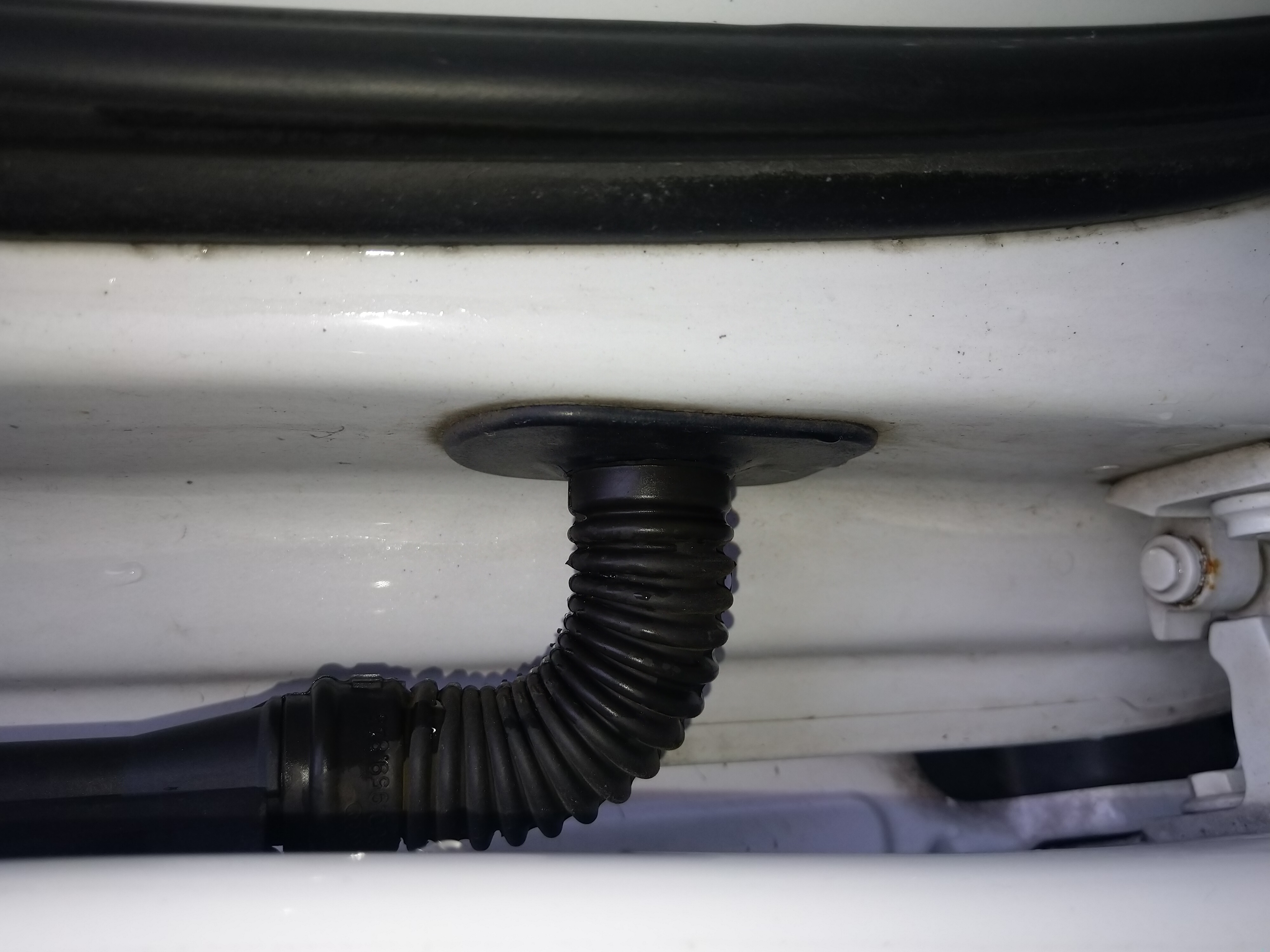

Even sitting in my dads golf earlier today, the drivers door does have a decent sized conduit.
It's like the VW one I linked on ebay. Chassis side is a rectangular hole in the car with the rubber pointing down, and then over to the door.
Although without cutting a new hole in the car for it, maybe not a perfect solution unless that side could be bonded in some way

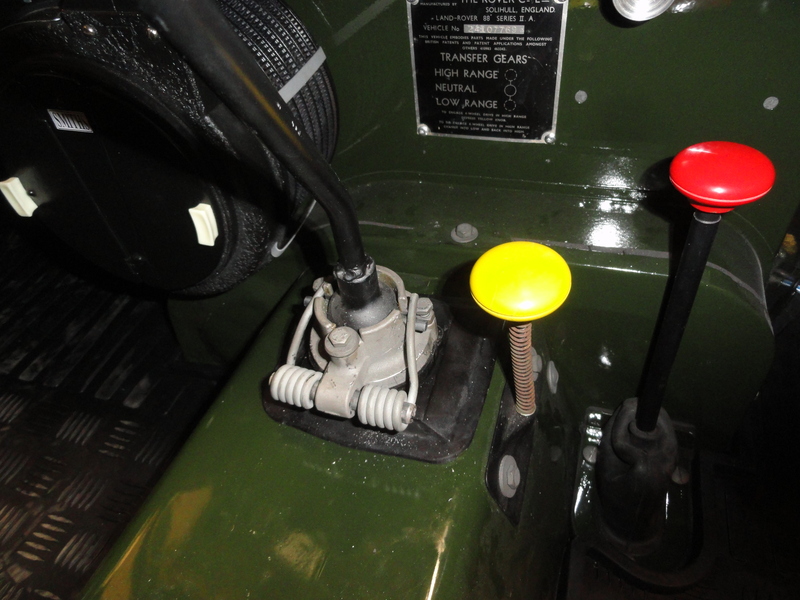

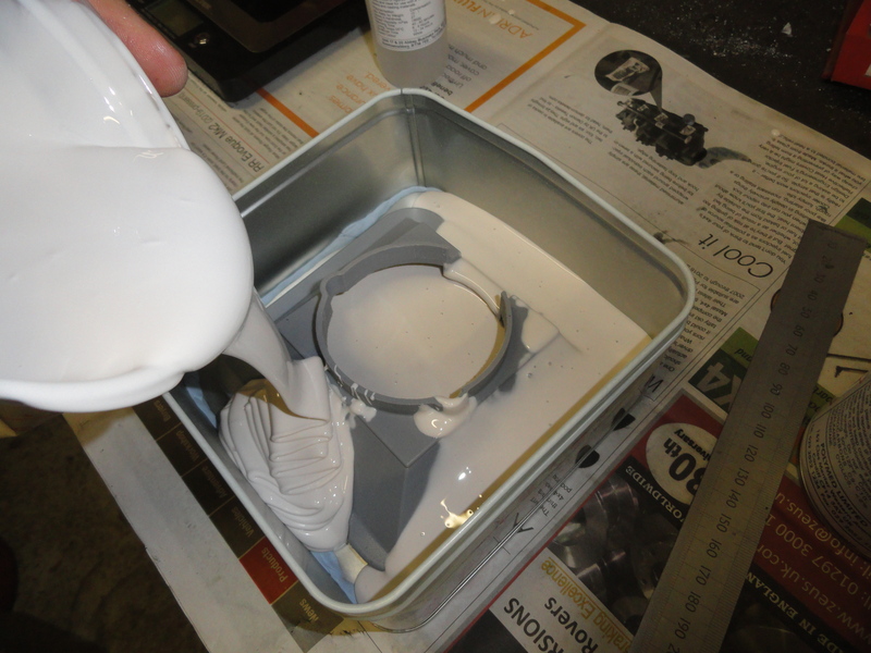

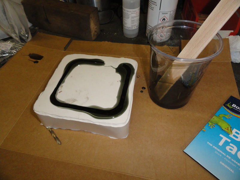

Here's another idea - make some new ones. I made a grommet for my Landie to fit an R380 gearstick to a Series transmission tunnel.
Simply design and 3D print the master, make a silicone mould, and cast the part.

VW/Audi door ( drivers )
- Posts: 4065
Re: Door wiring
Oh FFS they're sideways.
left is top
left is top
