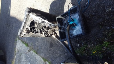

rich112
Posts: 106
Re: Tricks for cleaning a radiator
Post by rich112 »
This seemed to work!
