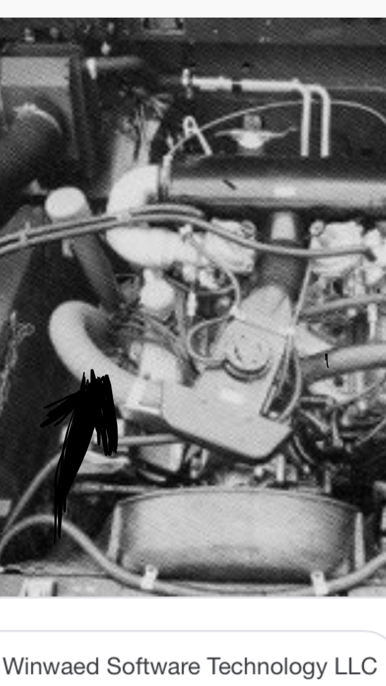

Can anyone tell me what the pipe with arrow pointing at it in the picture
Thanks Matt

Warm air from near the exhaust manifold.
The air-box has a temperature sensitive valve which draws warmed air from around the exhaust manifold if the fresh air is too cold.

Thanks for that.mines missing so I need to order a new one.Do you know the name or part no for the pipe please
Cheers Matt

Not offhand, but I am sure a bit of work on the Rimmer Bros website will turn up an answer.
