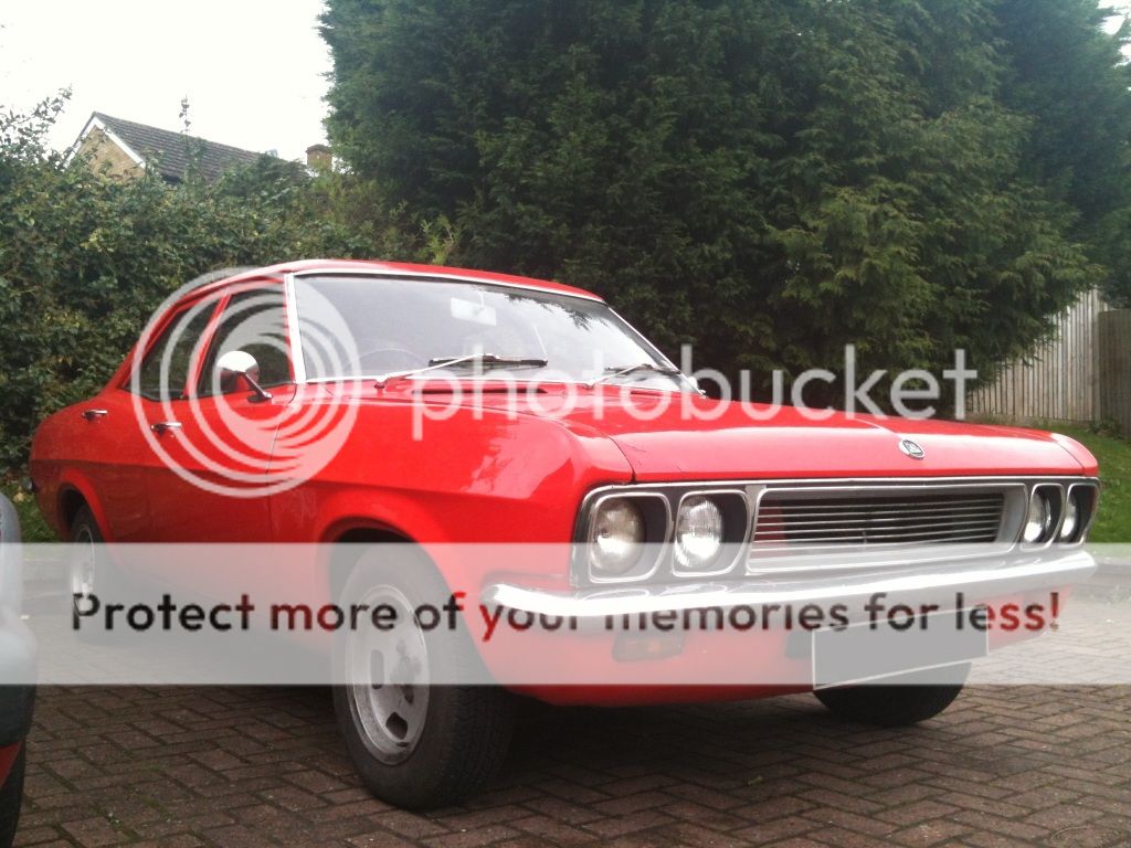

It's a Vauxhall Victor FD! And here she is:
The body work is great on it, it was fully restored and the chassis is solid.
Now, I want to upgrade her mechanically and put in a V8 (which one exactly to be confirmed, I am looking at options).
The car has a 2.3 4 cyl in there at the moment (which feels more like a 1.3l when you drive it) It's running poor and perhaps the rear wheel bearing is giving up because it doesn't sound good.
