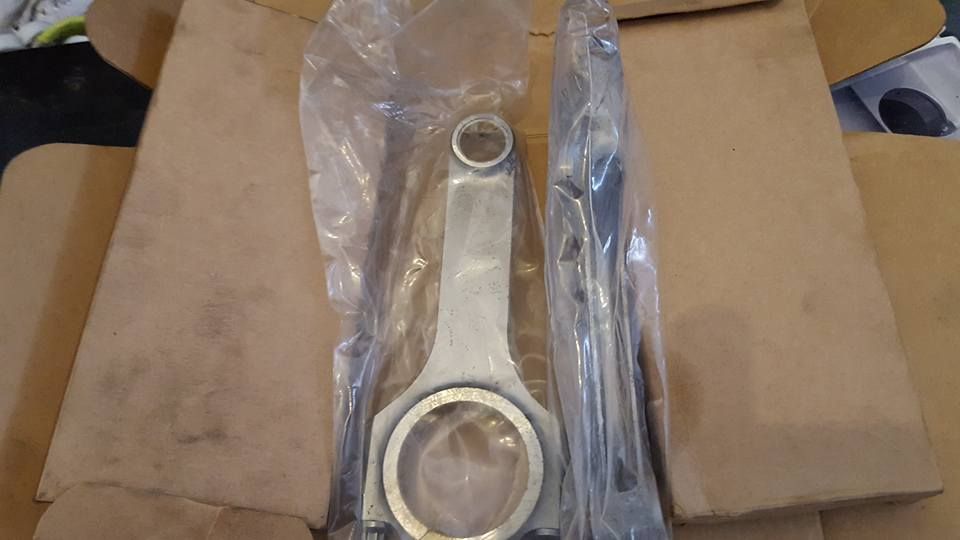

of my crank, new forged pistons, new con rods, mechanical cam, new innovate dual wide band controller, errrrr what else lol,

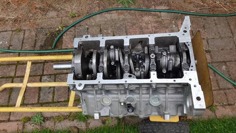

crank fitted and spun over smoothly,

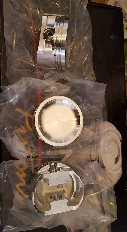

conrods fitted to pistons and the double spiralox fitted to the pistons,
gapped rings to the first 2 pistons, fitted first piston every thing was fine spun over smooth still by hand, fitted second piston and it locked up solid,
cut long story short they haven't machined the journals correctly and its pinching up
we tried two rover conrods too on the first journal just incase they machined the big end faces of the Lunati rods wrong, but the rover rods also locked up solid,
everything is all stripped down awaiting collection to go back to the machine shop :(

poop that's bad....is the journal not round or too big or something ?
Hi Stevie,
when they offset ground the bigends and reduced them to fit the chevy rod journals the never machined the crank journals wide enough to take the rods etc,

and came back a week later, still pinching up, its a possibility the little ends are now pinching up on the pistons, we don't think the little ends have been machined down enough to fit the pistons,

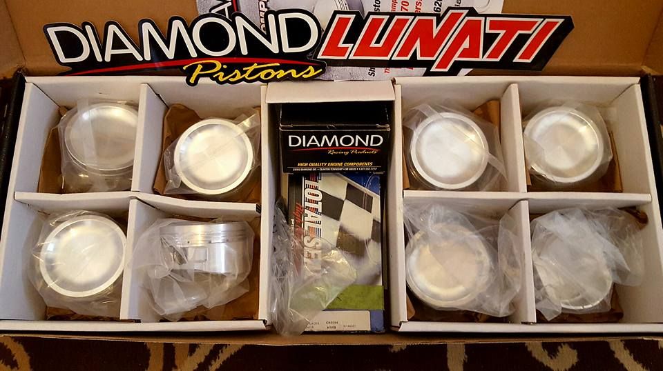

Diamond Forged Pistons & Lunati Chevy 6" H Beam Rods,
1.9" Inlet Valves, 1.6" Exhaust Valves, Not Much Room Left :lol:

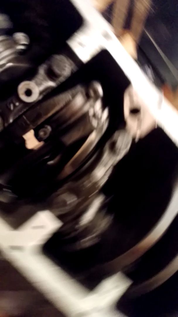

Just been informed that the short motor should be back with me this coming Saturday
And now turns over with the pistons all fitted
click picture for video of the engine turning over by hand at last :D

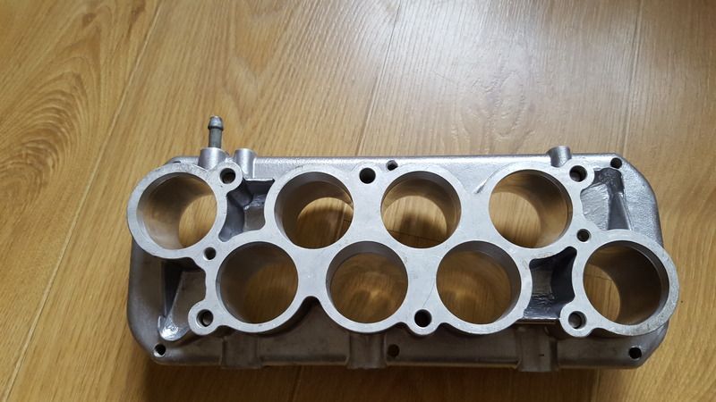

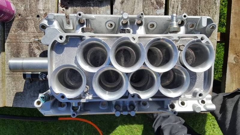

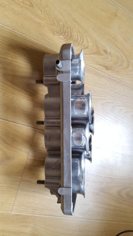

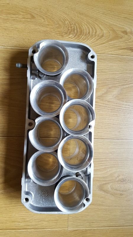

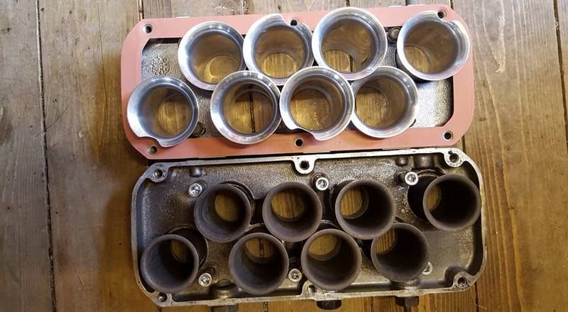

New 44mm trumpet base arrived today,
Busy old day today,

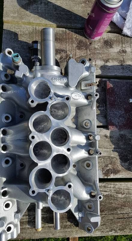

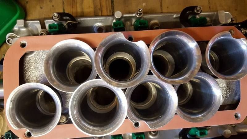

manifold opened out to match the new trumpets,
And with trumpet base fitted,

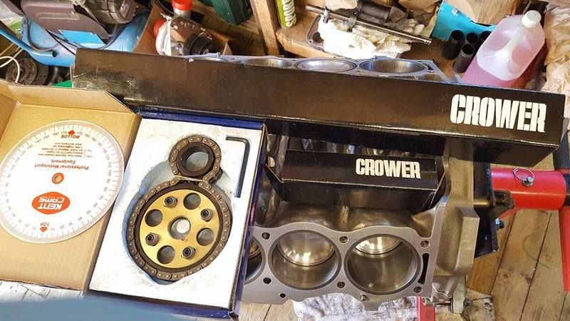

Short Engine Came Back Today Also
Crower 50305 Mechanical Cam,
Crower Mechanical Lifters,
Kent Fully Adjustable Cam Gear Set,

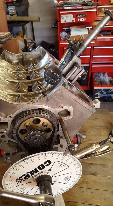

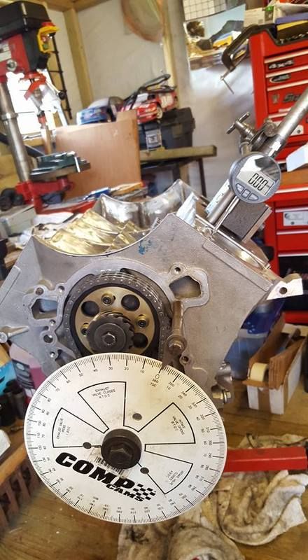

Setting TDC
Setting Dial Gauge On Cam Inlet On No1

Looking good, what was making the engine nip up ?
Not enough taken off of the little end widths on the rods,
was pushing the pistons over tight in the bore etc,

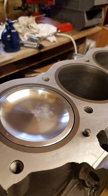

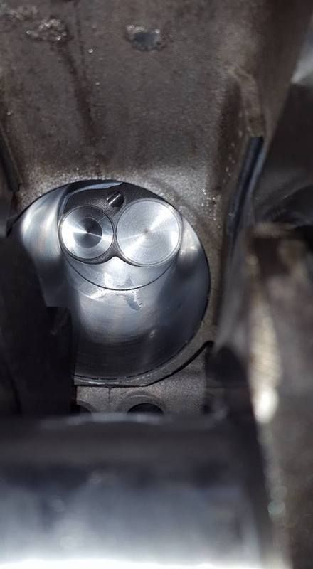

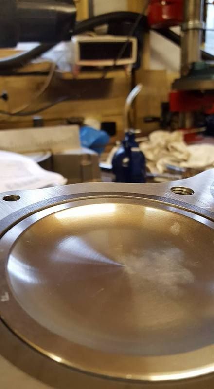

Have also found out today the inlet valve just slightly touches the piston on intake stroke so pistons coming out again to have reliefs cut into them,
I will get this engine built if it kills me lol
Pistons are now away having valve reliefs cut into the crowns as the valves just touch. So no clearance. Not good news.
