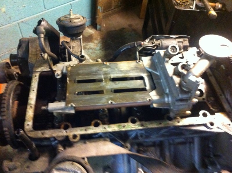

hmm, not the n62 sump I foundBMWE36V8 wrote: N62 sump has a hole from side to side for cross shaft for the four wheel drive and is around 4" deep at the front and about 8" at the back.......
Steve.
BMW N62 V8 - Upper Engine Oil Pan
BMW E63 650i N62 4.8l

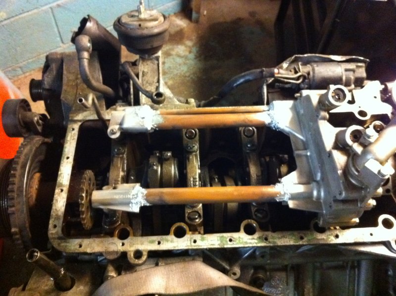

As I say, at the mo I'm waiting on an acetlyne reg so I can get a bit more heat for this Durafix to work, but this is how mine is currently waiting.
With Durafix you can weld dis-simmilar metals, as long as they are non ferrous, but not including stainless, so copper to ally is fine
Then once that is done, I shall be adding this for strength

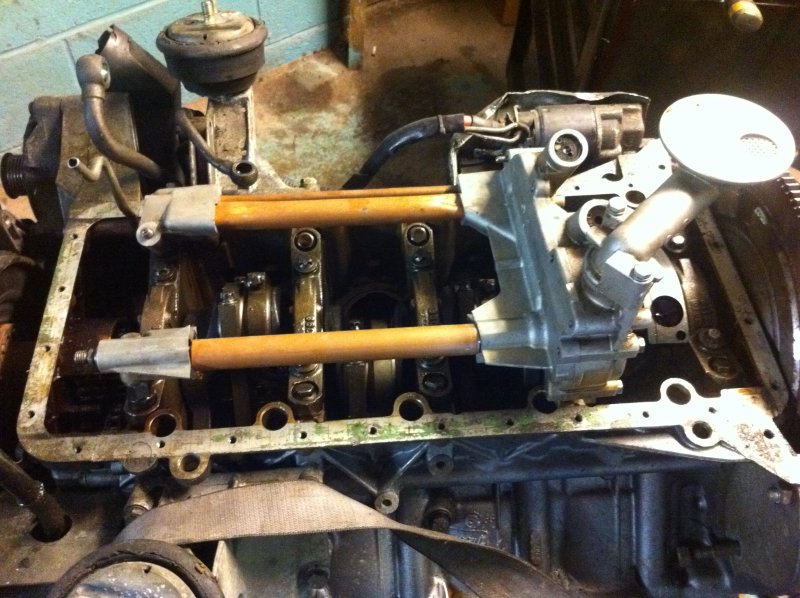

I know. What I can't understand, is you said you used the standard gear box mount.
When I fitted it, it sat nicely in place, the rear water rail didn't foul, and the gearbox mount fitted in the front 4 holes a treat.
Now it looks like the engine could go back another inch, but the next 2 gearbox mount holes to line up are 2 1/2 inches further back.
so I can see how going back an inch to put the pump where you have it, but this means the gear box doesnt line up...does that make sence?
It might be where my engine was slightly nose high (from where it was with my modifed subframe, the engine could go about 3/4 of an inch lower), now it's going to be sitting in level, that 2.5 inches might be obtainable?
Either way, long or short it will do the same jobbie. Only thing that was crossing my head earlier is, would that length of 22mm copper take the pressure, so I've cut a length of steel pipe that sits inside the copper a treat, that way I can still Durafix between the ally and the copper tube.

Yeah, my engine does sit fairly level, the only problem I had was with the rear water housing, which I cut off and had rewelded at different angle, it now clears the brake pipes on the bulkhead by 1/4 inch...........
Is your gearbox mount different to mine, I did start with a six cylinder car, wondered if mounting could be different........
Oil pressure, hmmm.......... I don't know what a piece of cooper would take, but I can tell you that mine gets up to nearly 6 bar when she is cold and revved over 2000 rpm and runs 5.2 bar when hot over 2500 rpm.......
