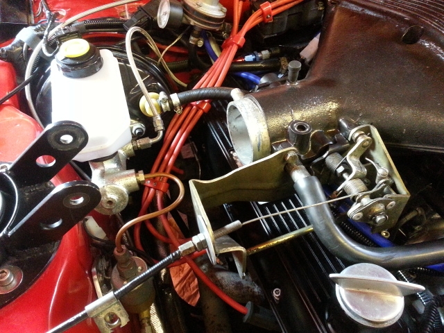

Welded up the throttle assemb today at work, came home and fitted it all, and we now have a fitted working throttle and pedal and a calibrated TPS
Just need to find a bolt/bung from somewhere to go in one of the threaded holes in the base (same size as the servo take off)
one of these bolts:
unless someone knows the thread size???
one of these bolts:
