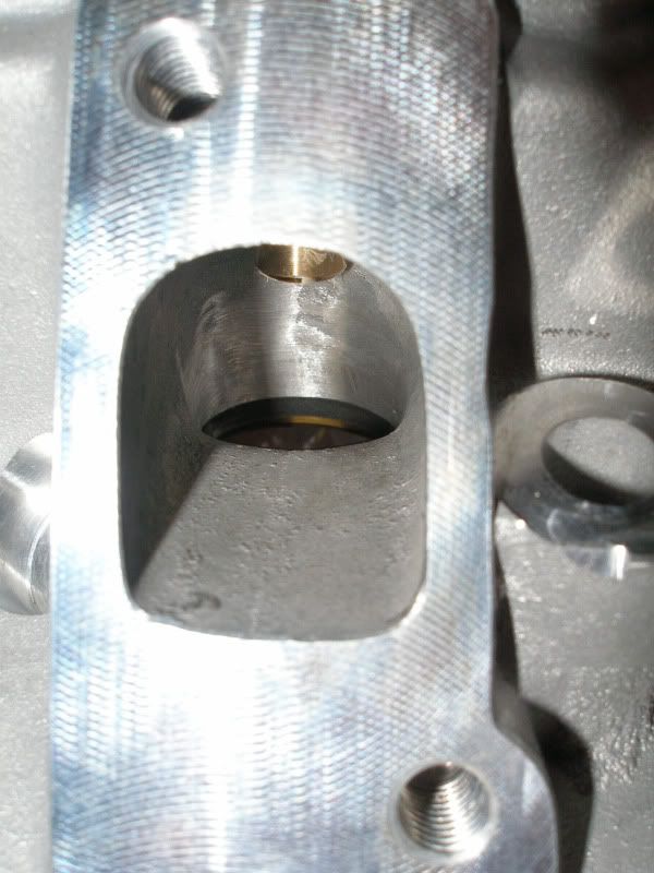

Just a thought but the way that the lump in the inlet track lines up with the valve stem makes me think that it's there to create some sort of divider to split the inlet charge before it hits the valve stem. I can't believe that it makes much difference though! (And I could be totally wrong anyway!)

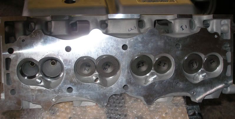

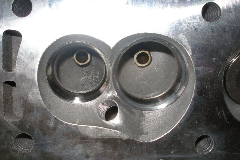

Looks poor doesn't it? We get some MGB heads from the US that need mega work to make em flow well. The Merlin heads seem unshrouded a little too much opposite the short side, not good for combustion, may cause prem detonation. It would be interesting to see a pair in the flesh. I cannot see why it needs the aerofoil thing-of-purpose?

I am interested in the exhaust port and it looks like a little work in the bowl area and raising the port roof a little would make a huge difference. I am not sure of the purpose of the vane but remember reading something a lot of years and even more pints ago. Will have to find the references again I suppose. I still think they are a screaming deal and seat of the pants feel on a road car will be better than any stage 3 or 4 modified Rover head. I do think with the little bl;ower cam in the dragster they will make a huge difference, just a shame they are not a straight bolt on. We would need new head studs so swapping for back to back runs is tricky, also RS don't have a stud kit yet.

On another look the inlet port shown in close up looks different to the rest, is this just the picture angle?

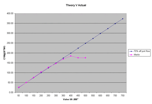

I ran the figures on the Merlins through the calc sheets I am putting together and from what notes I have the Merlin throat diameter was 39.5mm on a 45mm Valve.
From what my spreadsheets are throwing out it flows with 70% efficiency
Graph representation below
As it has been produced rather hastily and I am still learning as I go along with this I am yet to appreciate fully what its telling me ....that is if its at all accurate.
so pinch of salt with this one at the moment

When we developed the big valve race sd1 head flow stopped dead at lowish lifts until we really really carved out the chamber wall to the side of the valve, maybe same with Merlin head, no room for expansion to side of valve, difficult to say without testings and seeing in flesh.
