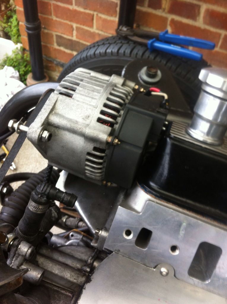

My alternator fits ok,but mine is in a different place to yours

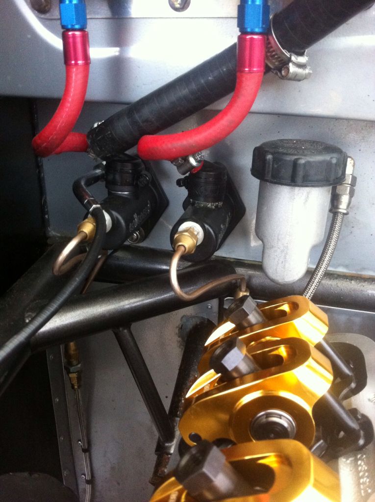

Mines fighting me in different ways,got to re-plumb the front brakes
Posts: 1285
Can't you replace the straight fitting with a 90 degree one and run the copper lines to the side and down?

unstable load wrote:Can't you replace the straight fitting with a 90 degree one and run the copper lines to the side and down?
I have ordered a 90* fitting!so great minds think alike !
I could of done it with the fittings I've got,but I would have to "break" the fittings every time I wanted to take the cover off ! :D

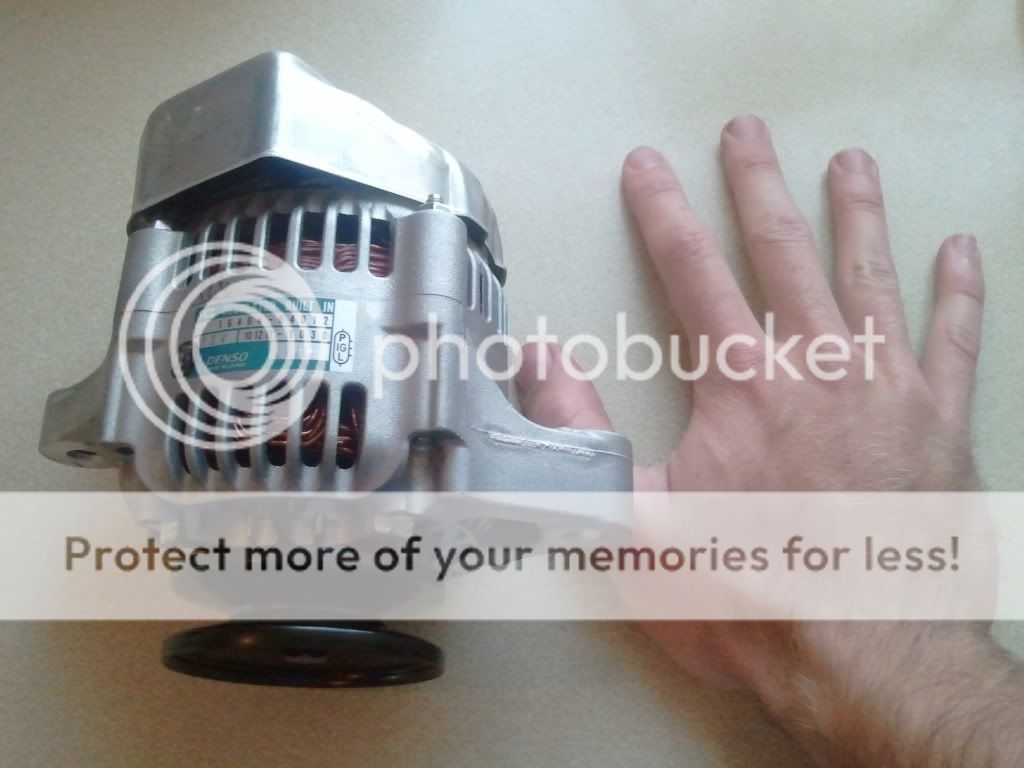

Might be too late but the Denso 40A alternator is a popular small cheap alternator from a kubota tractor, unless they put 'motorsport' in the description in which case they charge twice the price!!! :evil:

Superb quality little unit 8-) cant go wrong with Japanese alternators for outright reliability IMO nice work there Super V8 :D

I have bought something that looks very similar but rated at 60amps

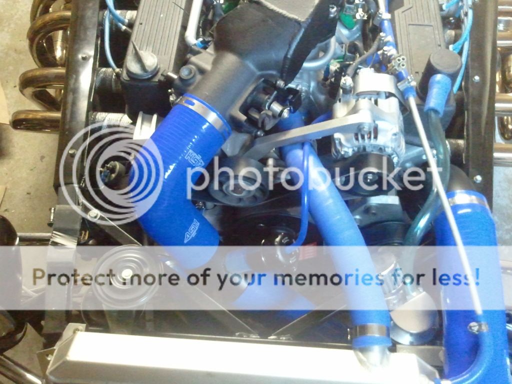

I used to mount the alternator where yours is but had to switch sides when I fitted the serpentine front cover to make way for my electric water pump.
Need to get a shorter drive belt now.

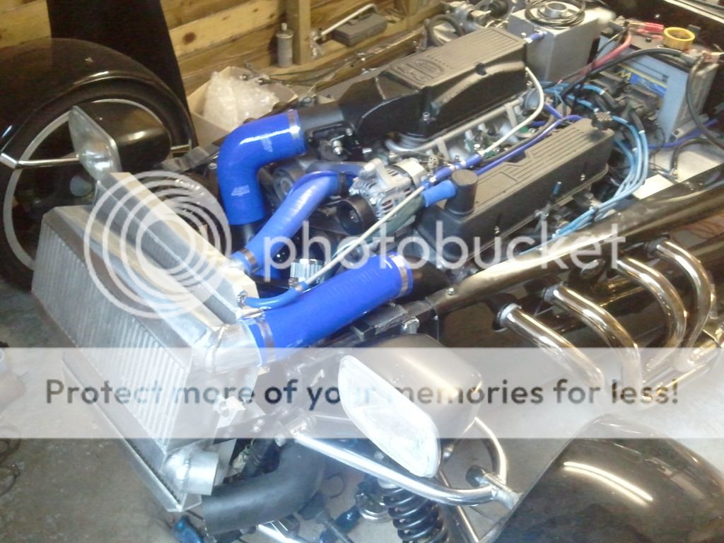

Finally got the new alternator fitted and wired up.
Was all set to start the engine for the first time. Turned on the ignition and straight away fuel started leaking from the injectors. bearing in mind that these injectors are supposed to be latest technology and cost £750 I was not at all impressed.
The injectors had a small ally adaptor to increase their length to match the originals and it appeared to be a bad seal.
Anyway I modified the fuel rail and did away with the adaptors and no more leaks.
The old injectors were about 200cc min and the old fuel pressure was 5 bar.
New injectors are 450cc ( as recommended by the supplier Mr. Injector ) new fuel pressure 3 bar.
So All ready, switched on ignition and pressed the starter. Engine turned over but wouldn't fire. In fact there was no spark at all.
I connected the lap top and found that the RPM showed zero even when cranking so clutching at straws I replaced the crank sensor which did the trick and the engine sprang into life.
Took the revs up to 2000 to bed the cam in but it was running so rich ( to be expected) I shut it down and reached for the manual.
Found that the Canems ECU has a feature to re scale flow / pressure
So entered the information and things were a lot better but still running on the rich side.
Then I lowered the injector resolution which had a positive effect and the engine ran much smoother and after the cam break in it even managed to idle reasonably well.
bearing in mind that I am new to this fuel injection I am really chuffed how it is running.
Now it just needs mapping properly.

Loving the new rocker covers

Nice work there 8-) just an observation but if that is cloth over-braided hose you have on that fuel rail bin it I have seen more failures using this stuff than I care to remember :shock: it may be fine at 1st but will be short lived 8)
