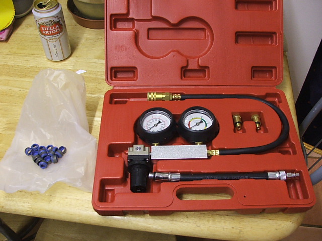

ordered a complete set of stem seals today, (spares)
going to do the easy thing first and change seals,
would you think the two cylinders that are burning oil on over run would be inlet seals leaking?
or exhaust seal? or both?
i thought due to the vaccum the inlet ones.

Yes T will be the inlet ones.

well battled home through the snow tonight to a couple of parcels sat waiting for me
one leak down tester and a set of stem seals.

Plus the essential can of Stella lubrication fluid :lol:
Kevin.
Posts: 6323
the other 3 empty tins are holding the lid up :lol:
