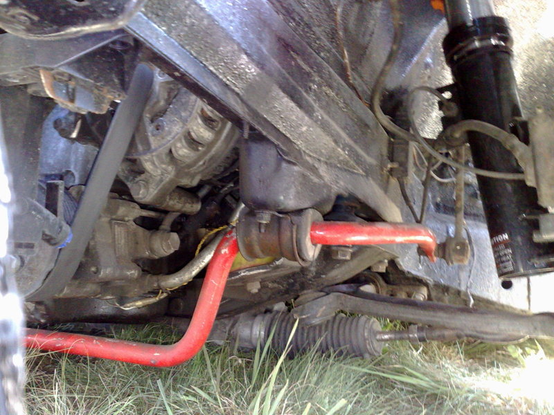

this is the E30 subframe, as you can see the ARB is at the back, and the rack is at the front (this isnt mine, it's an actual e30)
and here you can see the 20mm spacers that allow the engine to sit level in the bay
this crossmemebr is a direct replacement into the e36, and I've been told I need to use e30 328i wishbones, but i cant see why, as the e36 318i wish bones fitted straight on at all the mounting points with no issues?

I did not realise that, cool if you can make that work saves you a lot of work, the last picture, not sure thats safe and I don't think the insurance people would like that kind of modification, that was another reason for doing it my way, I haven't alter the car at all so the insurance was a breeze to sort out.....

his steering rack certainly doesnt look safe :)
