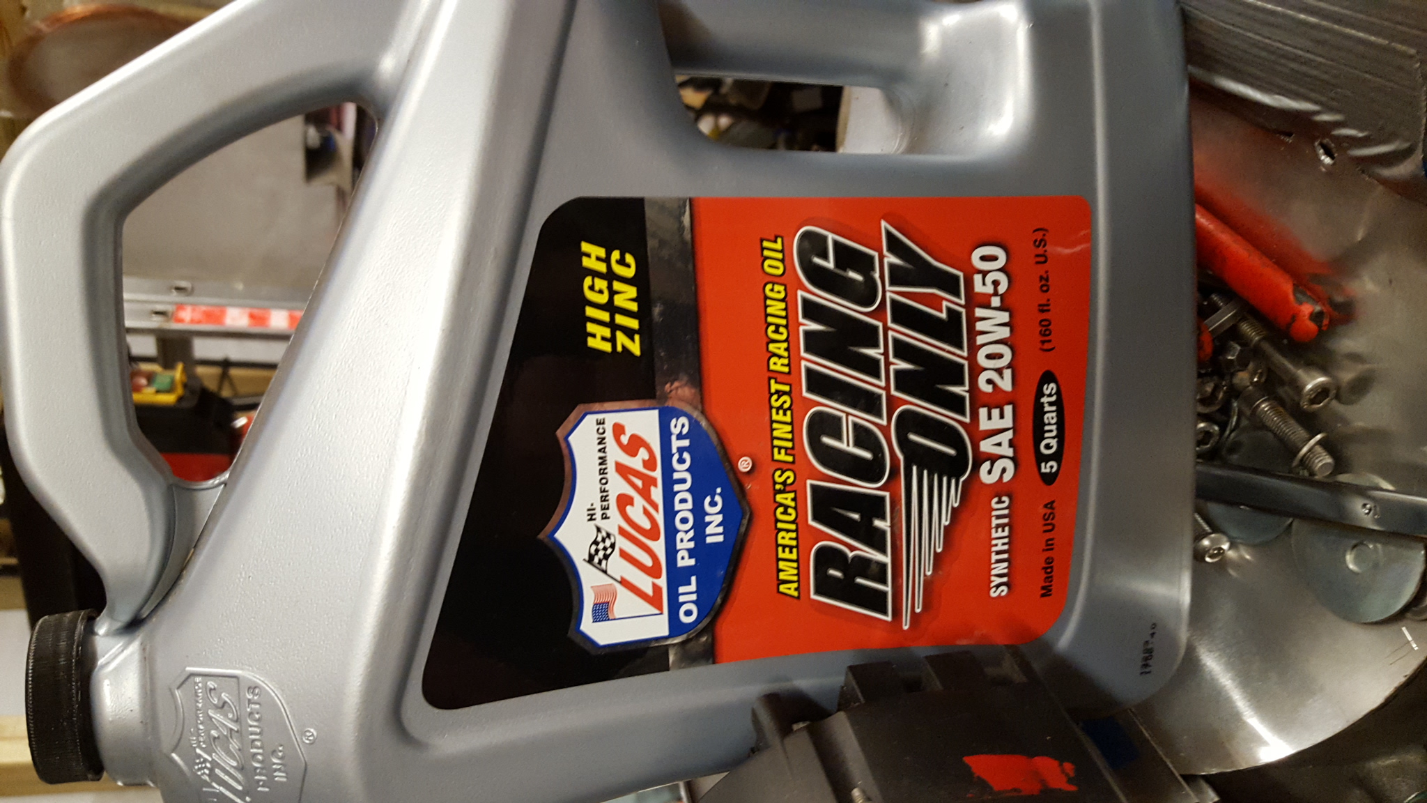

What I use and have done for many years even. In my current engine
Re: Engine Oils. which ones???
Plenty of zinc for the cam.
