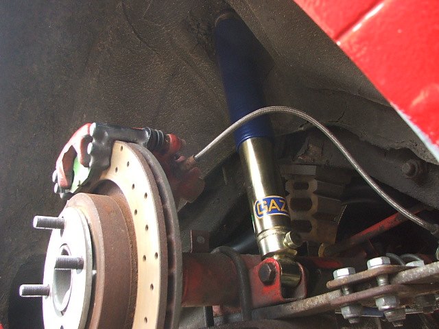

changed the old bilstien shocks to the new Gaz adjustables, (match the fronts)

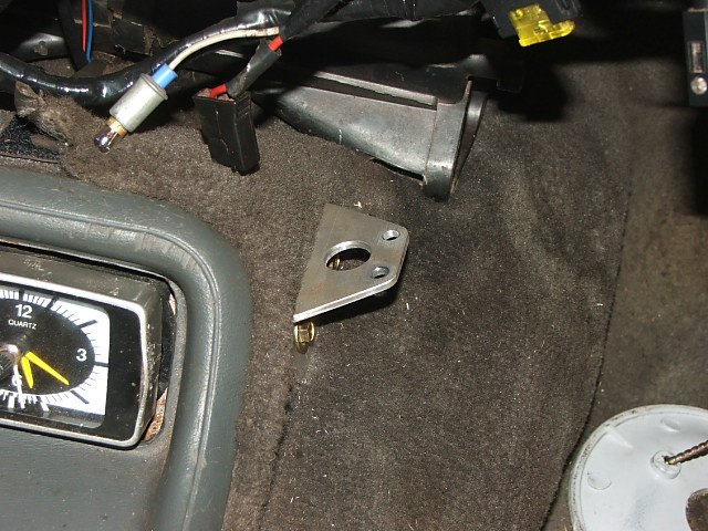

The new mounting bracket for the line loc was finished so i fitted it,

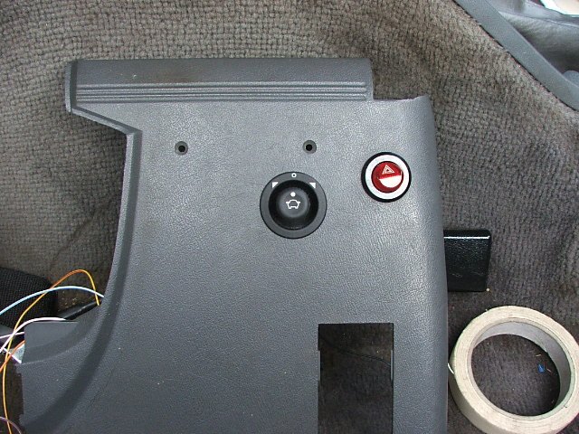

Modded the dash panel to take the O/E Ford electric mirror switch.

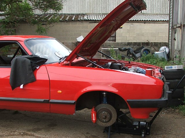

The bonnet went back on;

reason for the lecky mirrors the manual adjust ones have an adjustable joystick and it foul the roll cage,
Caprisport had a set of Ford electric mirrors that will fit the capri doors with a bit of work, so we decided to go that route,
