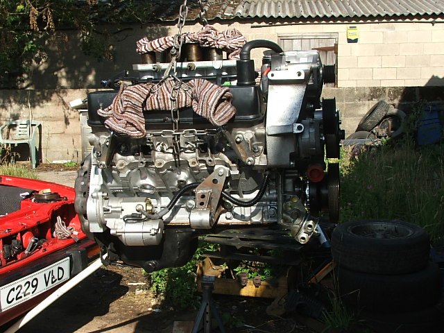

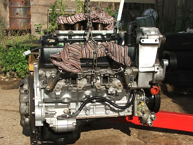

well the engine is out, (hopefully for the last time)
and stripped of its brackets etc and we have a nice pile of bits to go to the blasters from the car,
and before anyone shouts while looking at the pictures,
it is a crossbolted block and no not the 3.9 i use to have but a brand new stg3 4.6 engine. running 4.0 rover pistons. (high comp 4.6 :wink: )
thought it was time to come clean as few have already guessed what i was building and was only a matter of time it was slipped out.

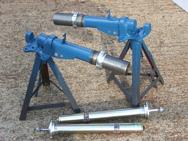

Coilovers ready for the springs and inserts to be fitted,
8 coats of blue they took fooking ages to do,

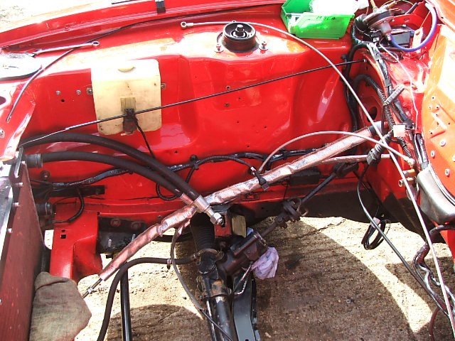

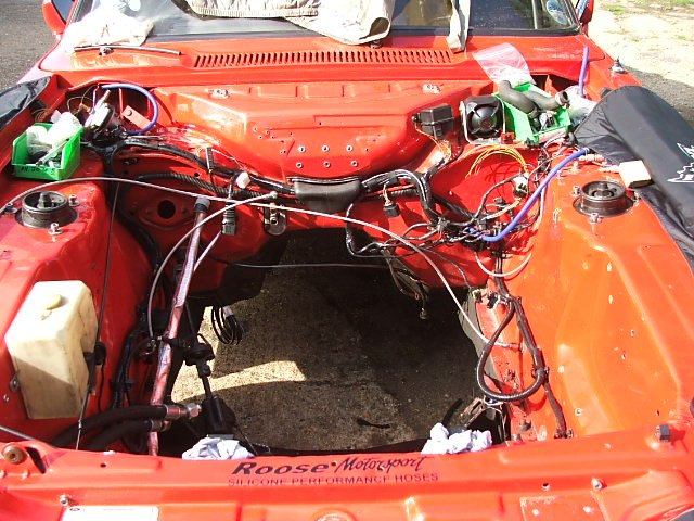

the engine bay wiring is now finished along with the crank and knock sensor shielded cables,

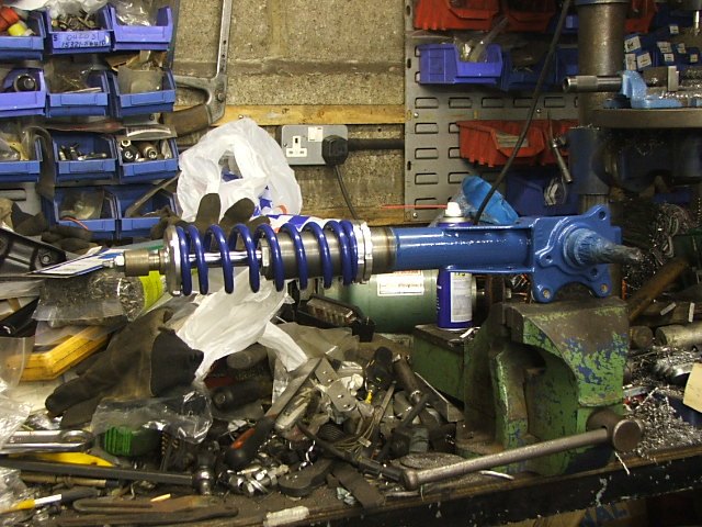

Coilovers are done, just need my roller topmounts off the struts on the car at present,

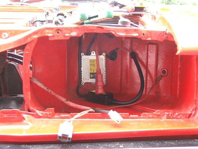

Installed a HID kit today (rain stop play to any other work) to the bmw smiley lights that we have fitted to the capri.
and foooookin hell they are a 10000% better and thats just in the workshop in daylight :lol:
ignitor pack and ballast pack fitted inside headlight bowl for the HID kit.

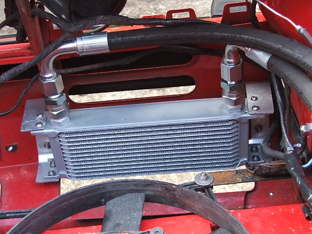

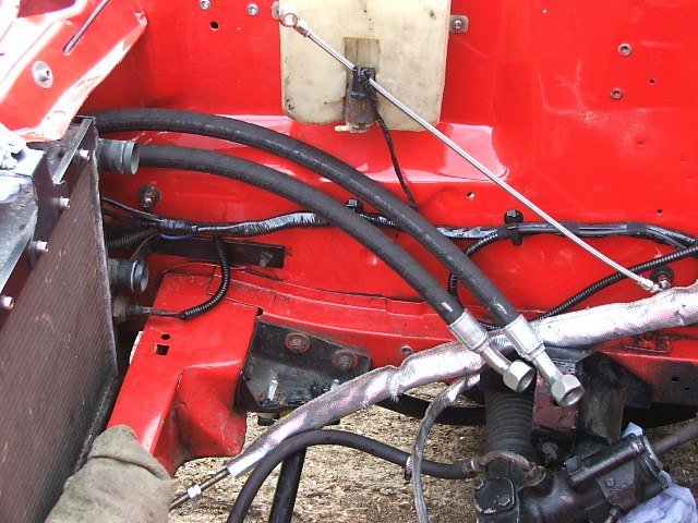

oil cooer pipes are all done at the cooler end (fans and rad can now be fitted)
how pipes sit after rad and fans are fitted,

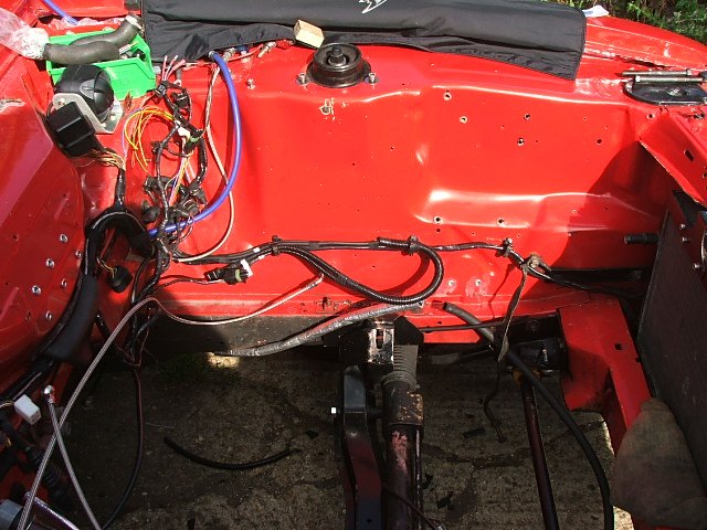

Engine bay, wiring,

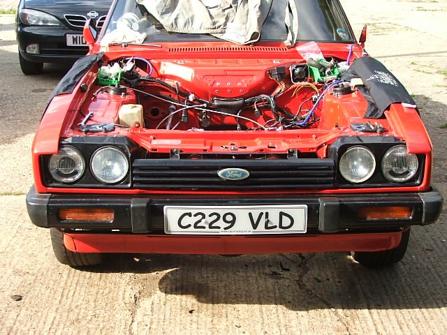

And the front end back together,
starting to look like my old Cappa again at last, :D

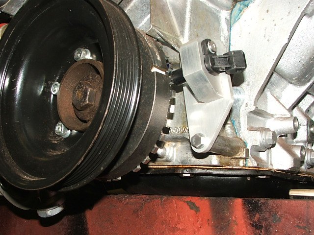

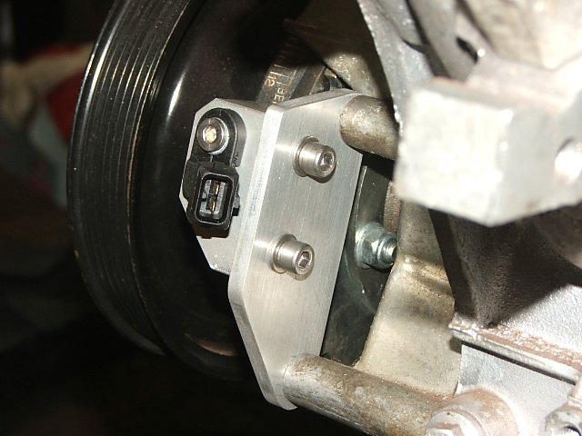

crank sensor bracket is now finished and fitted to the engine,
what should the gap be between the crank sensor and trigger wheel?
